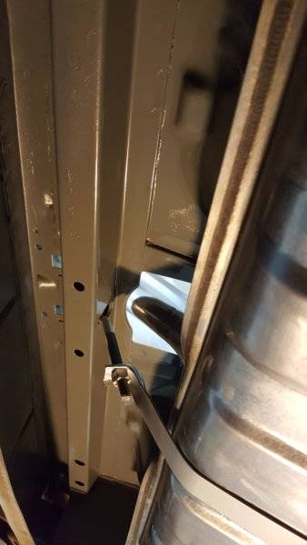

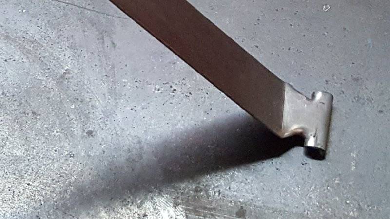

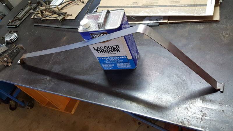

Now that I've had one of these things apart, I see how "ify" the design is. I don't have a photo... (maybe KhryslerKid does) but the end of the strap has a tab which inserts into the car body. This tab design reduces the width of the tank strap down to about a quarter of it's width. SO, if there is a little fatigue fracture in that tab.... well, yeah... nothing but trouble.

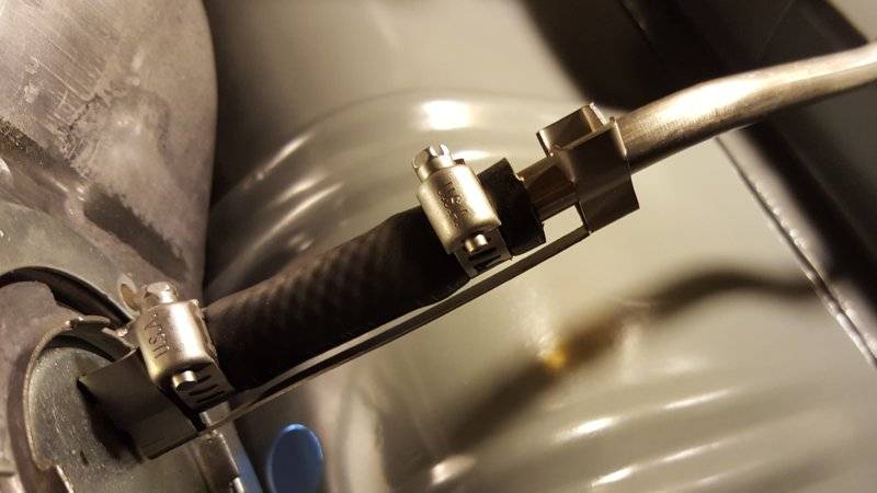

I think the whole reason for the push on ground clip was just to use the fuel line for a ground. It bridges across the rubber hose for a connection. Without it you won't have a working fuel guage.

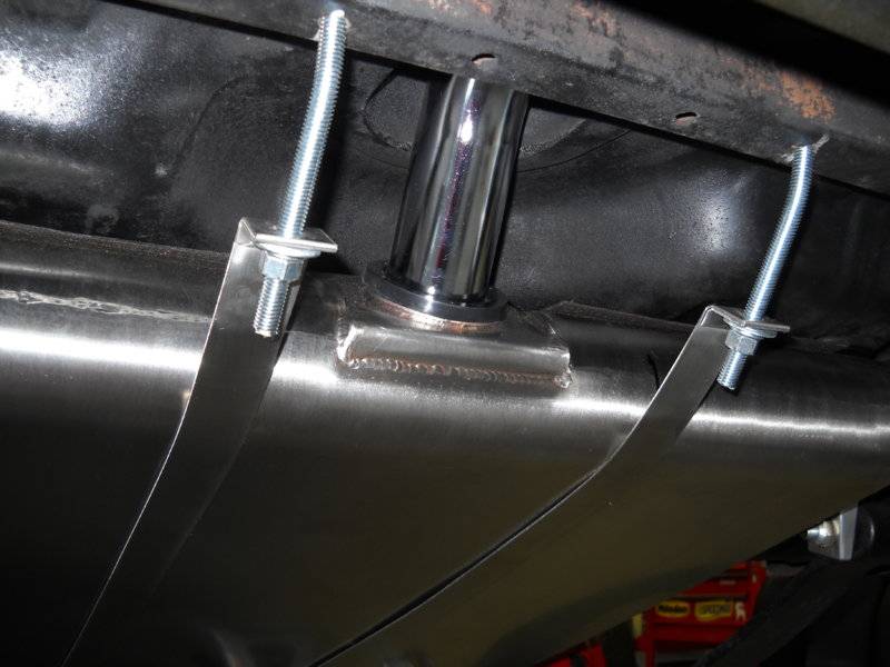

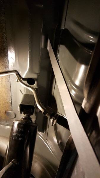

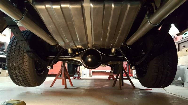

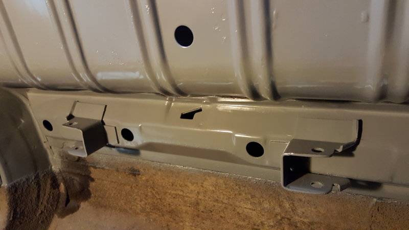

Yes, when I had my S/S tank made I requested 2 new S/S straps. The front of the straps hang in existing holes in the crossmember (see Kid's 3rd picture above- the round holes outboard of the shock mounts).
I drilled 2 oversize holes in the rear trunk floor and (2) 3/8" holes below those in the rear crossmember. I bought (2) 6" carriage bolts, put a calculated bend in them and dropped them through the trunk floor holes and through the crossmember holes. Worked out fine.
