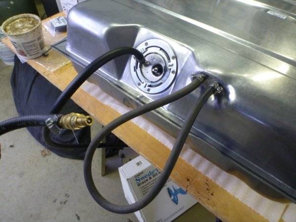

Im getting ready to replace my sending unit with my newly rebuilt original. I ordered a new locking ring and rubber gasket to be on the safe side. Last time i put a new sending unit in before mounting tank i put some diesel fuel in and stood the tank on end to see if there was any leaks around the sending unit. Is this acceptable to do or am i damaging the unit. Thanks
Since diesel has a lower viscosity to gasoline, it won't be much of a leak test IMHO.
Use normal gasoline if you must test in this manner....but be careful not to smoke while performing these tests....we would hate to lose such a valuable Forum member. :D
Or you could just pressure test it...

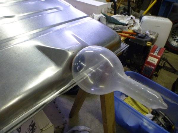

That thing on the right picture is no daddy to made sure the tank doesn't bulge?

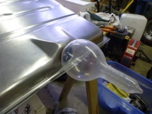

Haven't blown up an airplane wing yet and I've been doing this for 25 years... it only takes about 0.4 psi to inflate the condom and will show if the sender gasket is leaking.. or a supplier weld.

The air test does work though, use soapy water mix to find leaks.

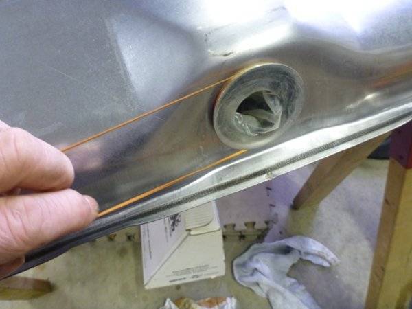

You actually want the lubricated as it helps seal it! Use a large elastic to secure it to the filler hole. I was just making sure the son's GF hadn't pin pricked his stock !! :)

Seriously though the air teat is the best way to find pinholes, leaks.
