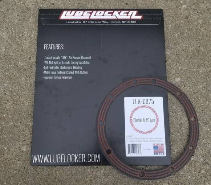

Anyone ever used one of these? Thoughts?
Kind of costly at $25 plus on Amazon, but maybe a good seal and forever?

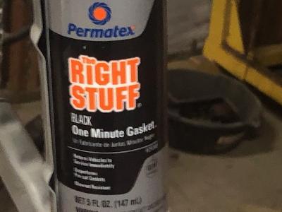

I use this:
This sealant seems to be the best that I have ever used. NO black, ultra gray, blue, orange or red RTV beats it.
I used to use gaskets on the 8 3/4" 3rd member but once I switched to just "The Right Stuff," My leaks have stopped.

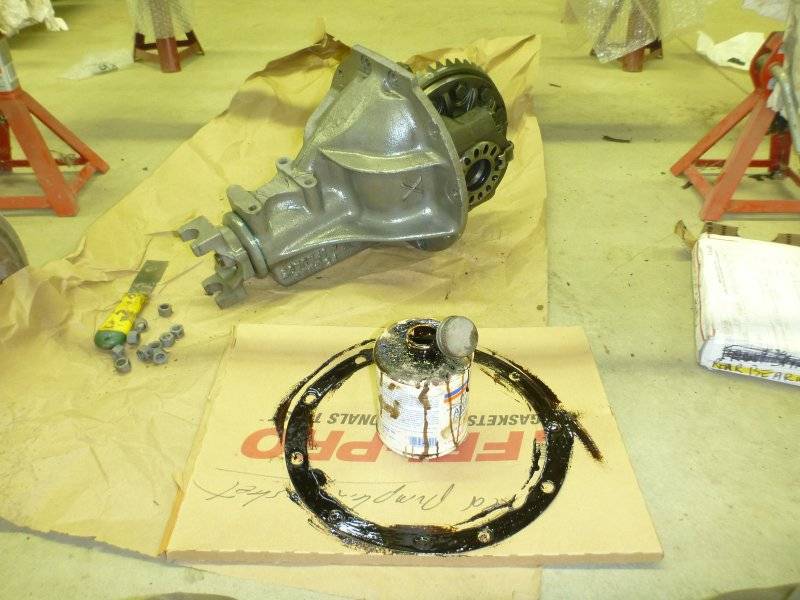

I just use a cheap paper with a very thin layer of black rtv on both sides.... never had a leak

Excellent gasket, great if changing rear ends frequently. But a couple of cautions... 1.Be sure the mounting surface is totally clean on the diff and housing. 2. When torqueing it down do it in (2) steps, the 1st @ 1/2 torque spec and 2nd final torque spec.
Just my $0.02... :thumbsup:
I have always wondered about the axle alignment thing, gasket, reusable gasket, no gasket at all. Then, there are the people that worry and fall apart about the bearing end of the axle. I'm going just continue to do it the the way they did it.
The reusable gaskets work very well provided U follow their instructions, do not over torque just snug it up.
