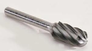

If you want to cut aluminum with a die grinder you need a bit with very few flutes. The carbide burrs that you typically see are good for cast iron or steel but clog up with aluminum. The burr assortment in the pic is for iron and the single bit is for aluminum. Also, don't use the long bits on a high speed die grinder. What will happen if you go too fast is the shaft will bend because it can't support the force.
