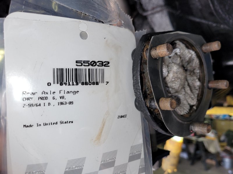

By any chance does anyone have the Felpro part number for the flange plate on a 8.75 rear? I know there was two gaskets, one was foam and the other one was regular gasket material. Either one will work
Thanks
Inner (between flange and backing plate) is steel, outer is foam... 55032 is the steel one..

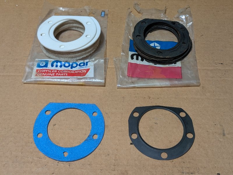

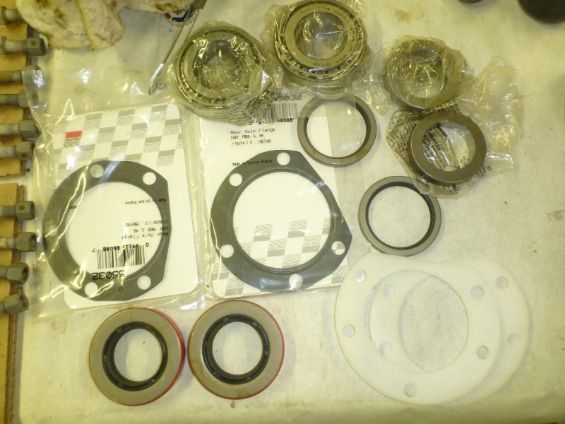

The inner gasket that seals the axle housing flange behind the brake support (backing plate), is a steel shim embossed gasket with a rubberized coating. The Fel-Pro number for this gasket is 55032.
The outer gasket that seals the retainer to the brake support (backing plate), is a sponge foam gasket. The Fel-Pro number for this gasket is 13800.
The following image shows the two gaskets:
The Fel-Pro foam gasket is typically white.

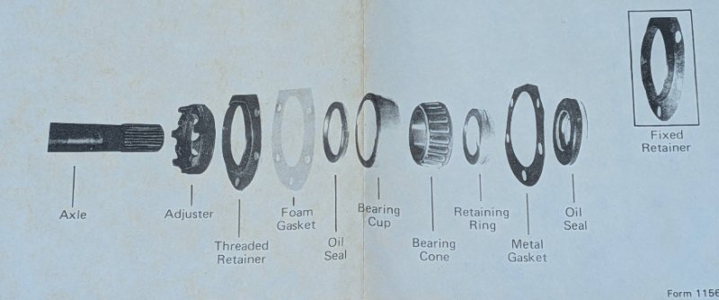

The following image shows the gaskets orientation.The brake support is not shown:
