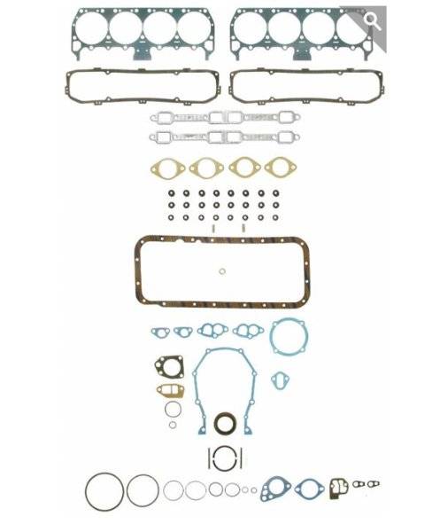

Looking for recommendations on a good quality engine gasket set.
1970 383 block, Edelbrock RPM heads, Edelbrock Victor manifold.
Tia,
Greg
Felpro master engine kit. Only thing I couldn't use was the head gaskets because I had to play with the thickness on my Cometic gaskets for compression and I bought a crushproof set of oil pan gaskets from milodon because cork sucks, especially with the double gasket and windage tray.
https://www.summitracing.com/parts/fel-fs7891pt11
Just used that kit ^ on my 383. Everything fit great. I always use the fel pro kits. Or save a couple dollars and use the sealed power ones, same thing.
