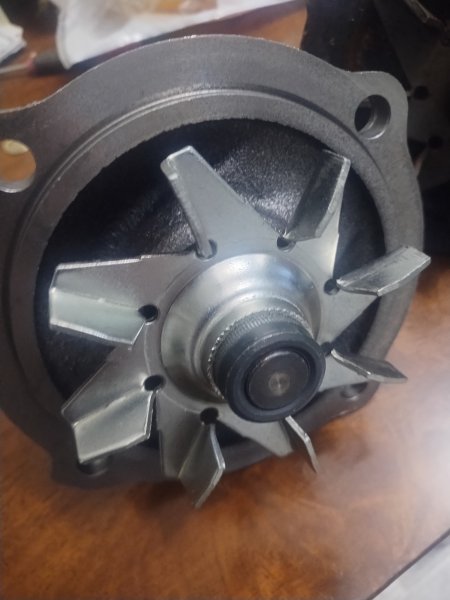

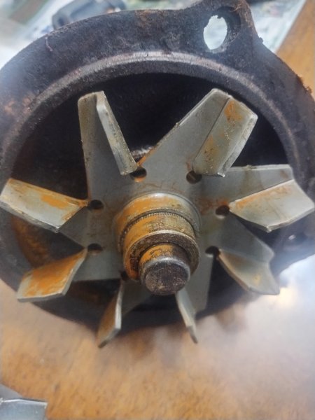

I have a 69 Plymouth GTX . Took off the water pump to check the blades . 8 blade pump. Bought a new gates from rockauto. The impeller blades are about 1/4 inch shorter. The old pump looks good except for very little play on the shaft side to side. Have to push on it to see any play. Wonder if they are selling the correct pump.. the casing is the same.
Post some pictures.
I posted some pictures

Bought an aluminum water pump and housing. Put pump in housing and it wouldn't turn, put the gasket it turned. I'd be reluctant to use one with short blades.
That water pump you removed was the wrong one for your car.
The new one you have looks like the correct pump and should work better now.
