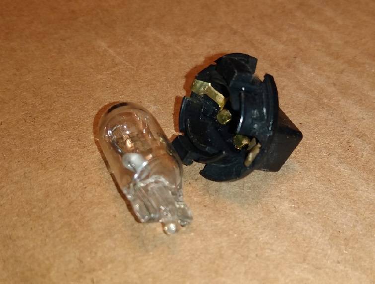

Curious if anyone has references/leads on gauge cluster LED lights. This is for the kind in the pic attached. I'm looking for either a LED bulb replacement or a LED bulb/socket combo replacement. These are the 3 bulbs/sockets on the circuit board for a '68 Charger.

Just do a search on eBay for 194 LED. I found the best results with white but it will be all down to personal preference. They're under a dollar each and usually come in packs of ten so you could experiment with color choices.
If you what a stock looking dash you will need 'Warm White' led bulbs. 'Cool white' bulbs will give you a noticeable blue shade to your cluster. I like the feebay ones. They are so cheap, so if you don't like em no big loss. I went thru 3 different types to find the ones I liked.
