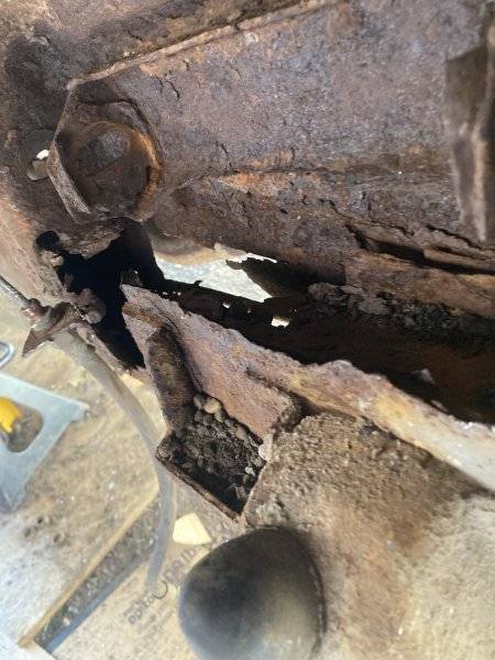

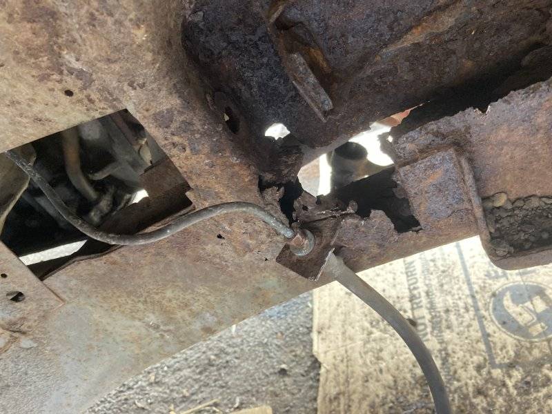

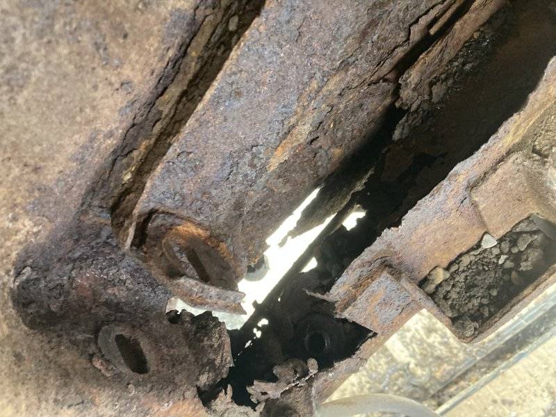

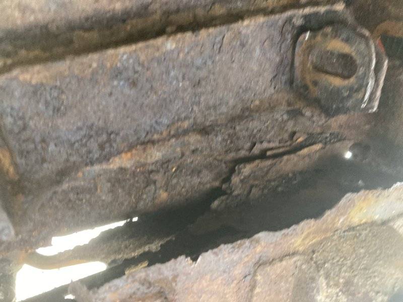

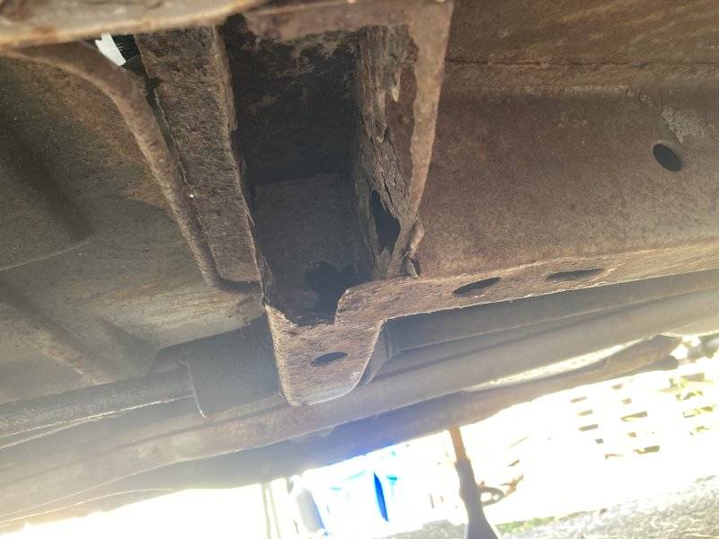

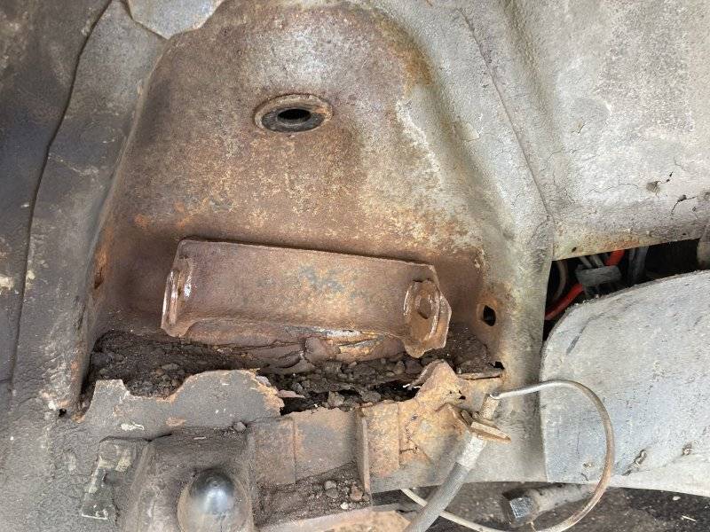

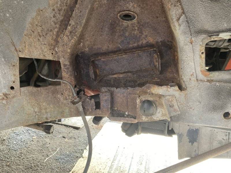

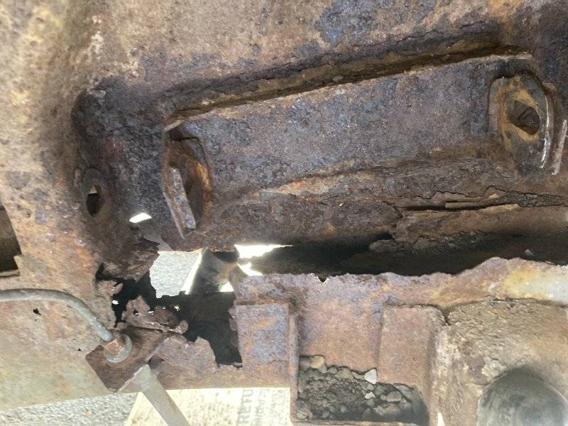

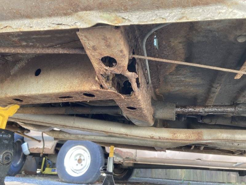

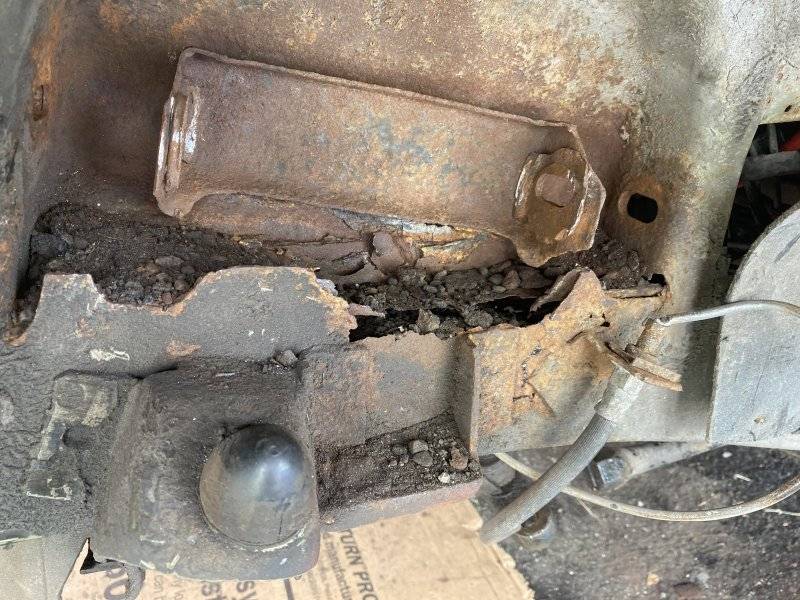

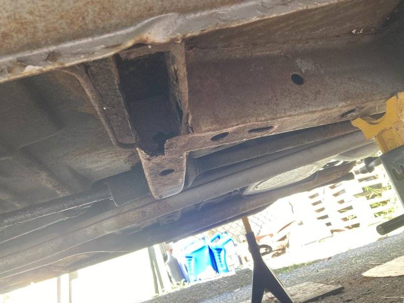

This is the subframe on the passenger side. I guess I should replace the whole subframe with a new piece. Or should I fabricrate. I think I have to take the motor out and the fenders and hood too.
Replace the car imo. On my 73 Barracuda it started with the front frame rail ended up everything but rockers and roof. I only used factory frame pieces
AMD is going to be your new best friend. That car needs a lot of new metal....
or a solid donor......but if the donor is solid, just build that one :rolleyes:
Exactly what I was thinking, but didn't want to be the first to say it. Don't think I would bother with that car unless it was something rare like a Hemi or A12.

Ouch
Before you start you will need to take everything off the front of the car to see what you really have
By the time you clean the ugly back till you find good metal it might just be easier to change the whole frame rail
Sounds like you might know how to weld
Just becareful you do not take too much apart at a time and hate yourself for even starting such a project
Try to do one side at a time
Oof!!!! I would replace the entire frame rail. It is a pretty intricate area and that rust looks nasty. Inner fender skirts look good. Framerail and upper shock mounts are suspect.

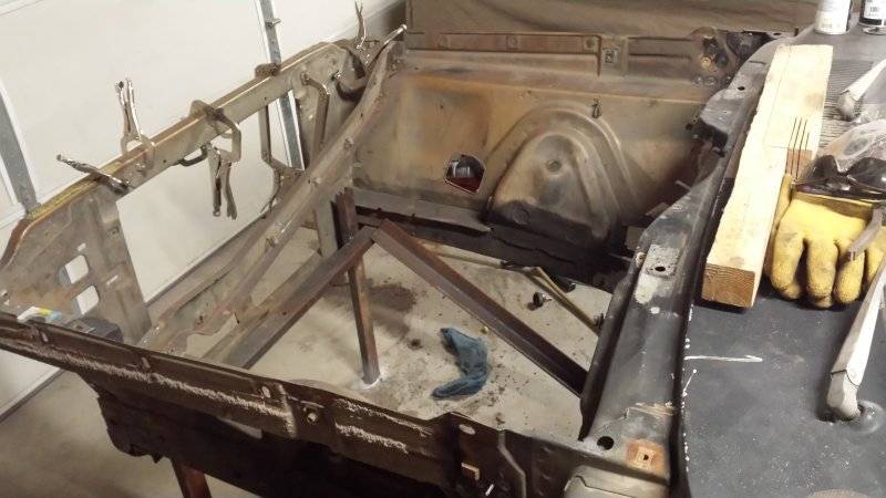

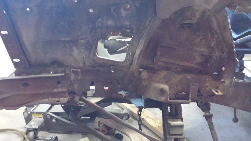

I had a similar issue on my 69 GTX, driver side looked as bad. I ended up grafting in a new, complete doghouse from a donor car. A lot less work imho.
Old
New
Notice I welded up supports under my front end before taking anything off. And I painted witness marks on garage floor where the supports are. New section went on perfectly. Scabbing the two parts together is a whole other topic.
