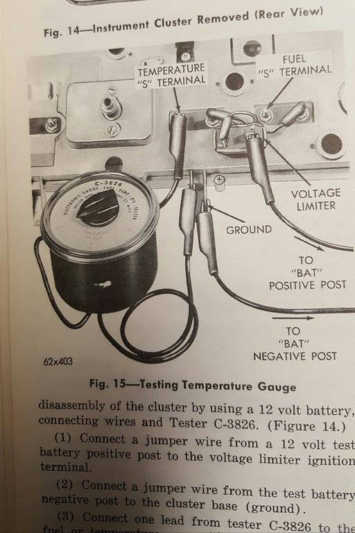

I want a tester! Are they available in the market place or do you have to make one? In the FSM they were useing one. Seems like a dealer item.
Make one. The fancy case isn't needed, nor the switch. All you need are 3 sets of resistors that add up to (10, 23, and 73) and wire them between leads or if you only want to see full make one with 10 ohms and solder in the resistor.
