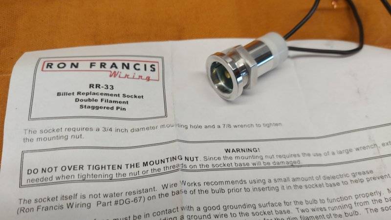

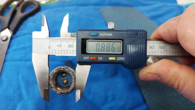

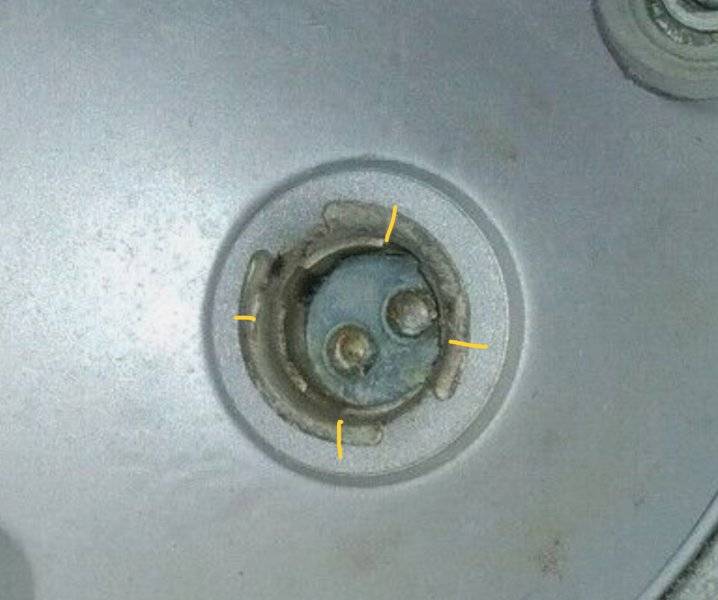

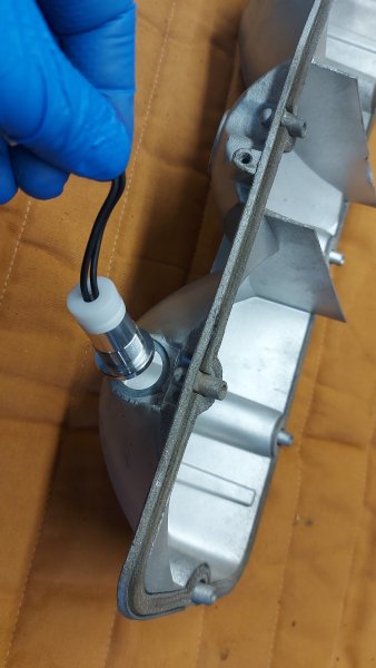

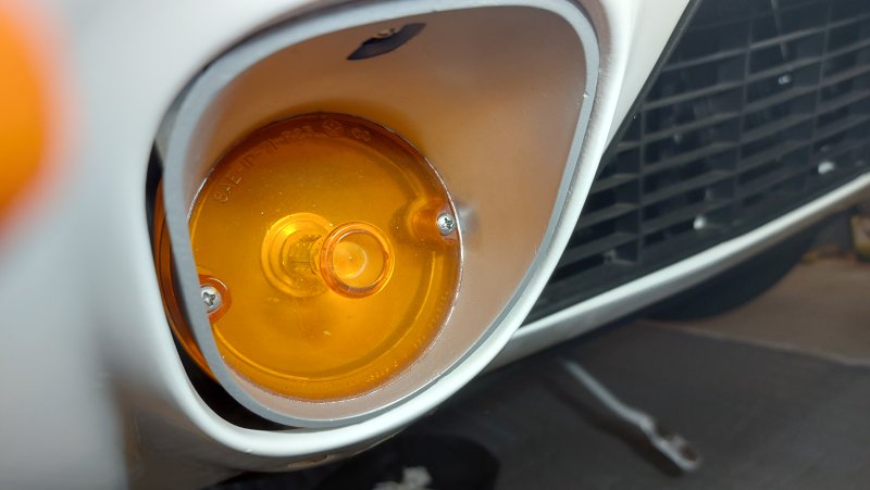

I will fix the front signal housing and put the repop switch on the column and try it.
