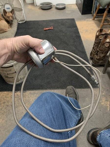

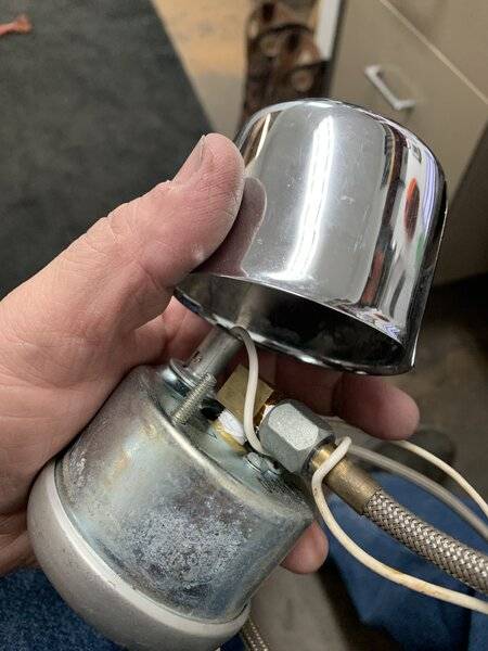

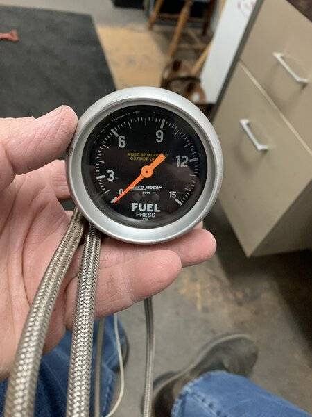

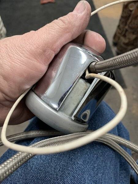

I ran mine from a Tee. I couldn't afford an isolator as a poor PFC in the army. Attached it to the hood. Slide cup off and the wire is behind it.
