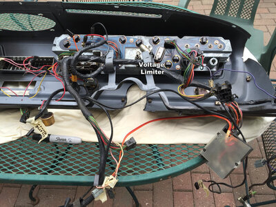

You may have fried the voltage limiter on the back of the cluster.

This is what the back of the dash looks like. I believe this is the voltage limiter @moparmarks is talking about.
You can drop the fuse box down somewhat for a better look by removing the big Phillips head screw on the dash frame lip directly below the box. Do your dash lights and the oil pressure light work? If so and it’s just your temp and gas gages not working then the voltage regulator is a good place to start. I think from your description of smoke I would pull the bulkhead connector plugs loose and check for any signs of melting on the plug side and receiver side that could allow cross shorting. Does the alternator gage work?
