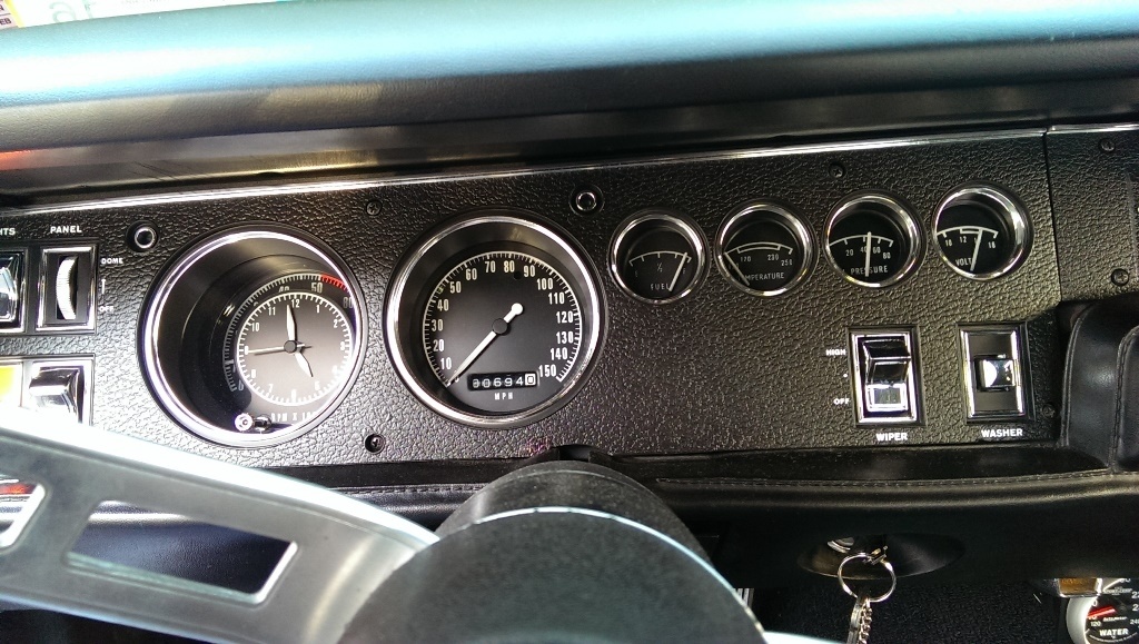

Update-----I called Instrument Specialties today since they did the ammeter to voltmeter conversion in my cluster. I was told the voltmeter is getting power from the same wire that powers the gauges. The voltmeter still works which means the cluster is getting power so the most likely culprit is the voltage limiter. Won't have time to take it out to test for the next few days so I just ordered a new one and I will hope for the best.
Do you have a picture of this conversion? I would like to see what it looks like,
Found this pic
