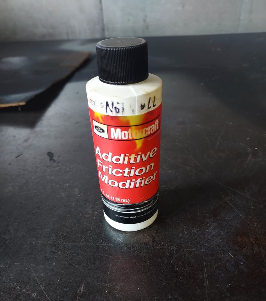

Sounds like it was just over filled. So just remove enough below the fill plug to add 4oz of friction modifier. The best is Motor Craft found at your local Ferd dealer.
