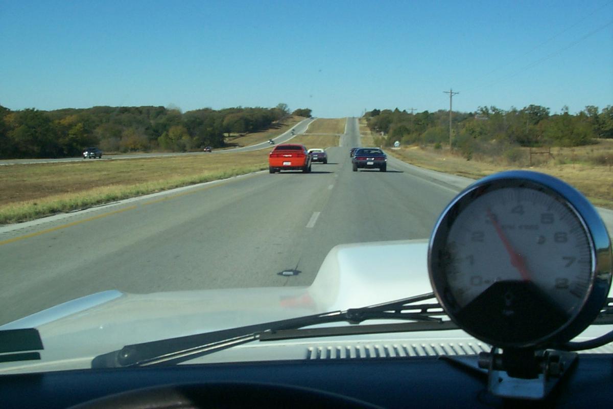

Here's a pic I took while on a lil highway cruise in my Duster. 360, auto, 3.91's. Runs just fine.

Yeah, 3.91 and tall tires should do the trick.
