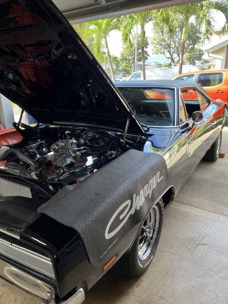

Any trouble with 3:55 gearing 528 lift 284 duration 112 lobe separation cam and 24-30 converter on a 69 Charger
440?
MP .528 isn't a huge cam. If its closer to a 3000 stall 3.55s are likely needed to keep it from slipping at cruising speeds. If it is closer to 2400, 3.23s would be ok. That also depends on how the convertor is set up for driving.
