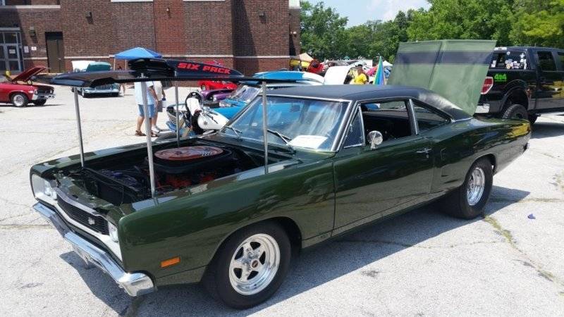

I have a 69 Super Bee 4 speed that has been converted from a 383 car to an A12. 8 3/4 rear with 4.11 gears.440 6 pack dynoed at 520hp. Awesome pull, but a little wound up going down the highway. Looking to make it a bit more drivable, as I don't really race the car much anyway. But, an A12 would have had a 4.10 from the factory, so I'm tempted to keep it.
Cheaper to change the gears to 3.77 or 3.55, but a Gearvendors overdrive could be the perfect solution. Keep the shorter gear, and less rpm on the highway. But around $3000.
So, trying to figure out if I would be fine and happy with a different gear, or would adding overdrive be the better, albeit, more expensive option?
Any of you guys been through this or have any suggestions?
