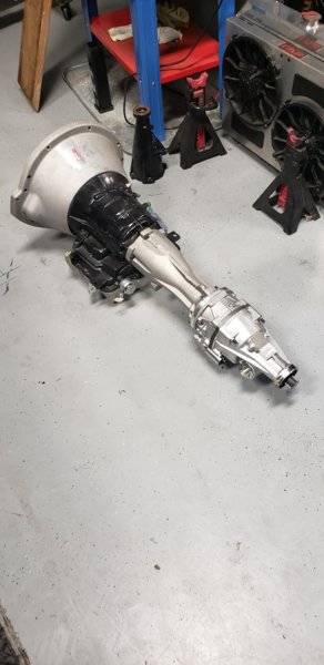

I'm installing a 2 speed power glide with a gear vendors overdrive behind my 543ci with 4.10. I'll let you know how it goes.
Powerglide with gear vendors . Its 7inches longer than a stock bb727
