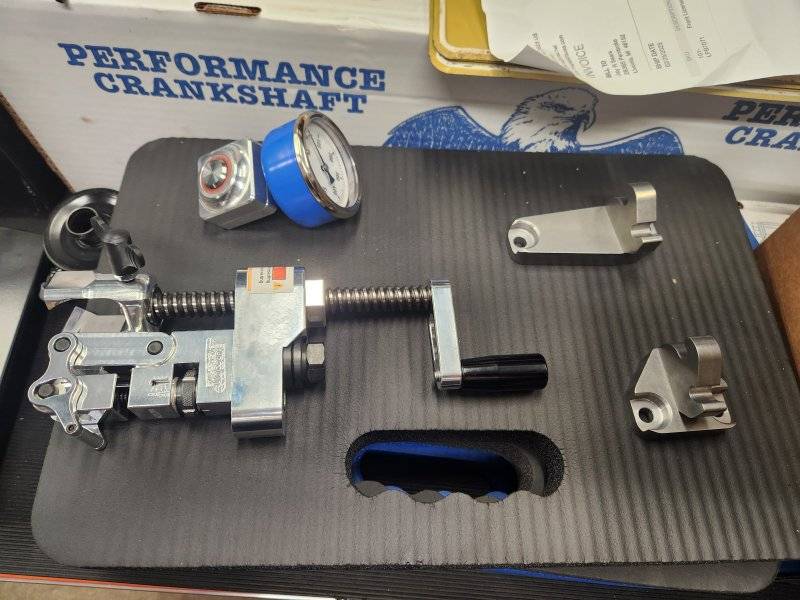

I have one from Buxton Engineering. Pricey, but nice. You can check and change springs in the vehicle. Mine is for the RBRE rocker system. You can purchase different bases individually for many others different kinds of engines as well that adapts to their kit. You would think for the money though it would come in it's own nice storage case, but it doesn't. So, I made one with our Sta-pak packaging machine at work to keep everything separated and protected.

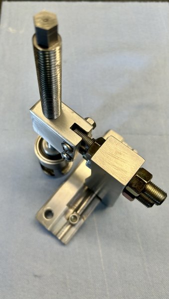

For a wedge, not a Hemi; but I just made this last weekend starting from a stock stamped steel rocker arm….
I built this valve spring compressor recently. Based it off of some pictures a Buddy sent me.
