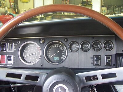

I have a 6.1 in my 68 Charger with the Gen 3 harness. I sent my gauge panel to Redline gauge works and had them rebuild the gauges and convert the amp gauge to volts. I am using the 545RFE 5 speed truck transmission so needed to convert the speedo to pulse along with the tach which receives pulses off of a coil pack. Not sure which harness you have but the directions I got with mine said I had to supply my own source. Something to the affect that I needed to contact the manufacturer of my tach on what they require to gain a signal for the tach from a Gen 3 Hemi. Mine needed a wire off of one of the coil packs. I think I spliced into either number 4 or 8. Here is a pic of my gauge panel
