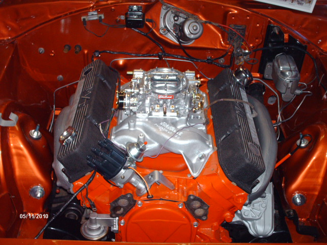

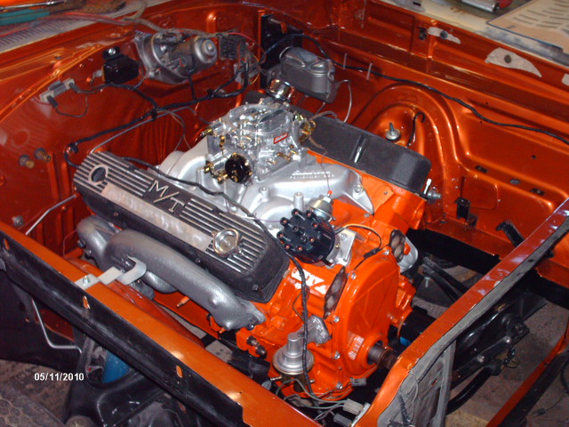

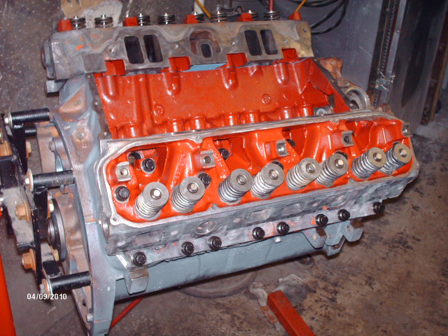

got my motor back! about time!
got my motor back in short block style mounted heads and used that paint on the surfaces where oil flows

is that copper or bronze paint in the engine compartment? is that going to be the color of the car?if so that will look real good on that B-body.can't wait to see pics when it is done.:yes::yes:
