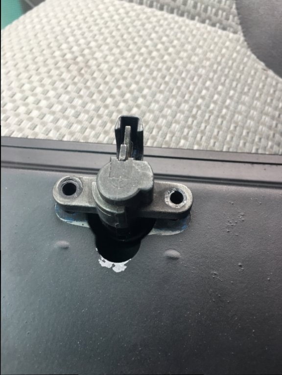

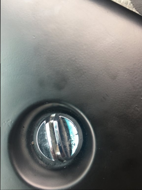

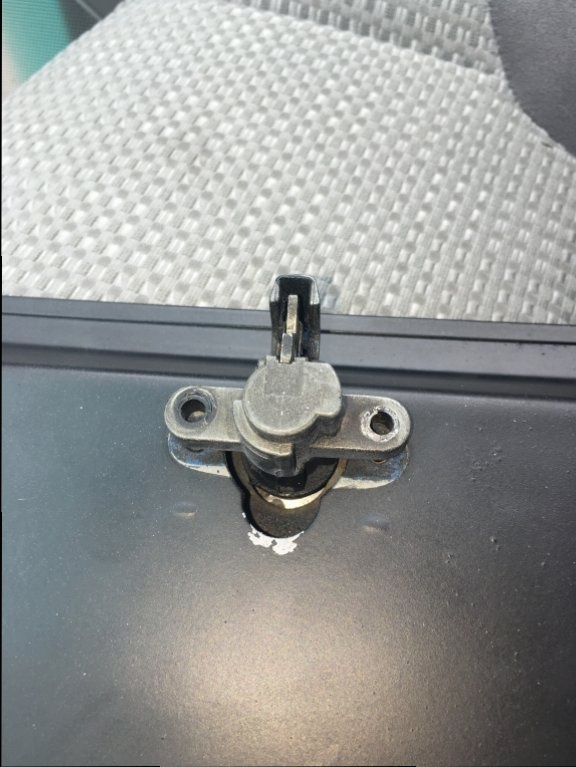

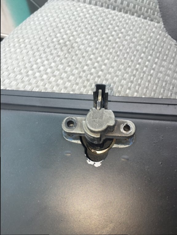

ok, last question for the day, I hope. Last night I did research, watched a YouTube video on the process. I stuck wires in the little hole. Nothing. Today, I took it to a locksmith who looked at it, said he didn't know how to get it off, and suggested I take it to the local Dodge dealership. The problem is, I don't have the key.
I'd like to save the catch half and just replace the lock cylinder and chime side (Classic has them).
How do I get the lock off with no key?

Find a good locksmith and have a key made.
A good locksmith can do it without destroying anything.
The only way to get it apart is having the key turn the lock into a specific position
To be able to access the pin to release it.
Without the key you are sol
Yeah, I read a post on a Challenger board today and came to the same conclusion. I'm now looking for a good locksmith. In Southern California, that is as easy as finding an igloo. Lately, if it isn't made at Ikea and doesn't have an electronic door lock here, there's pandemonium, brush fires, freeway accidents, and protests! :)

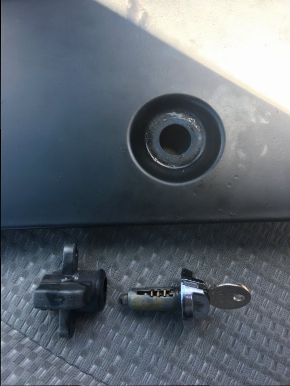

A good locksmith, 15 minutes and $20. He had to pick it for a while since the first pin was stuck. He's going to key the new cylinder to my trunk key when I get the cylinder (out of stock at Classic).

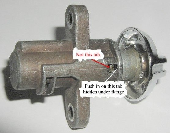

I've got a 72 RR that I am trying to remove the lock from the glove box. I have the key but the question is what to do to remove the lock. I cant see this pin that people are talking about. Does it have to be in the locked or unlocked position ? Will it just pry off with the key in it ? Thanks for any help I'm trying to get the dash repainted.
iirc
it has to be in the locked position (why you need the key)
and when you press the pin
you might need to wiggle and pry on it a little to get it apart
nothing crazy, but some are stuck in there pretty good..
