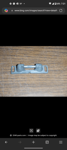

Look at your latch to see if it is broken. That bar should be at the top to receive the lock mechanism.

I had the same problem, I put some tiny washers underneath the "little bar" at top so that it was good and tight, Problem disappeared.

Try adjusting the upper catch bracket the lock connects to
