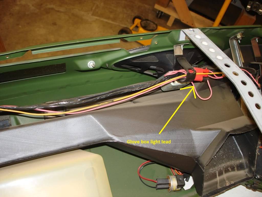

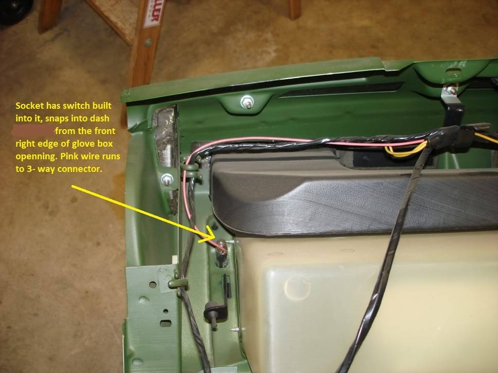

how did the glove box light mount on a 73 roadrunner. i assume the light had to be on a bracket. i found a light on on a bracket shaped more like a L shape and assume thats for the glove box. just dont see where it would have mounted to. does anybody have a pic or something of the glove box light

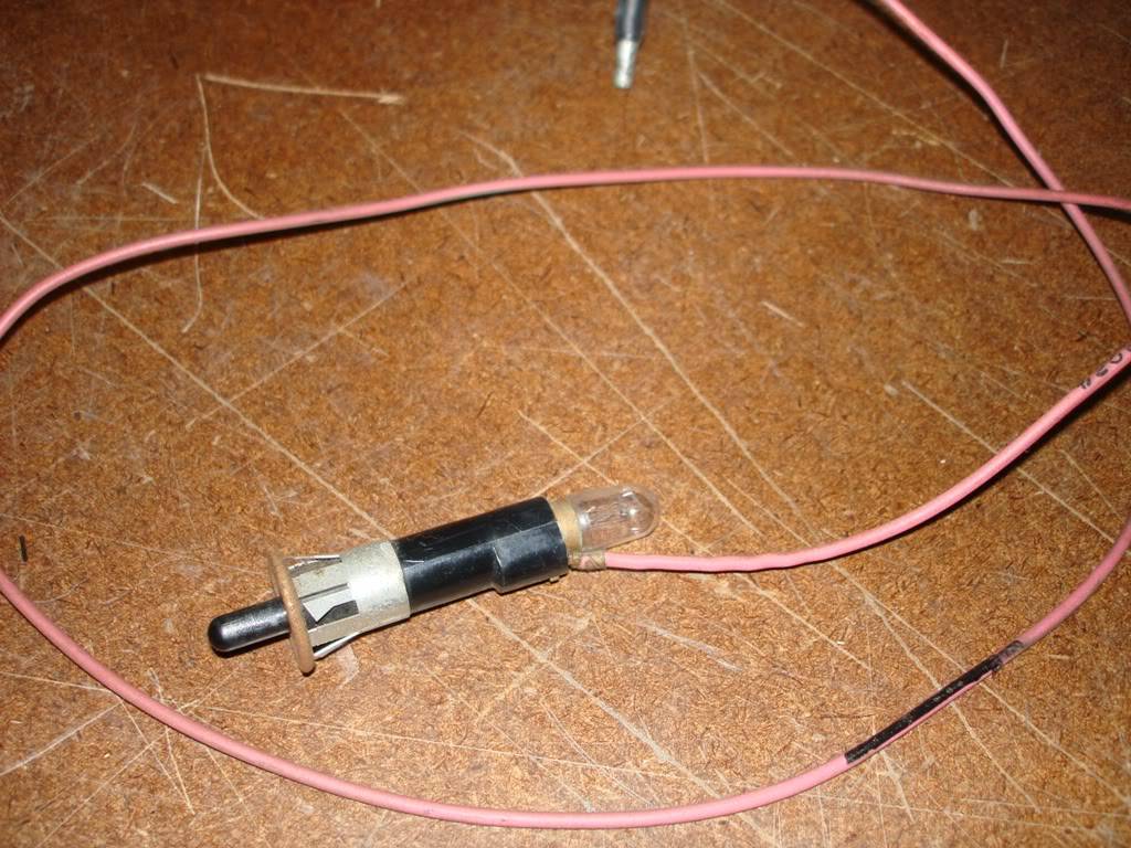

ok so the button is the light too then. hell i just thought that is what turned the light off and on. on the back part of my button i dont have a light on it. is there anyway you could give me a close up of that man. i really appreciate it.
I'm glad you posted a pic of this... That PINK wire gave me some fits a while back (cigar lighter connection), but I wasn't aware that it came together at a three-way connection near the speaker. I'm fixing to replace that front speaker soon and this pic helps me know what is going on around that area.
thanks alot man. hell i had to do was put a bulb in the end of the switch. who would of ever guessed a bulb went in there. put one in there and bam. light came on. push the button in and light goes off. great man. really appreciate it.
nice pic, thank you for the info. who sells those?
