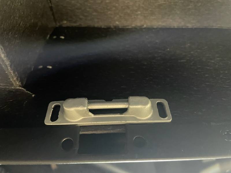

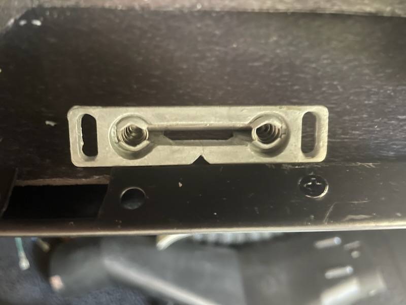

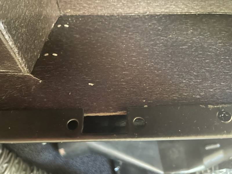

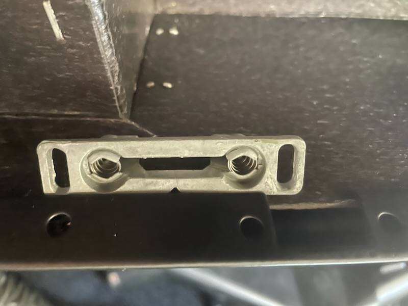

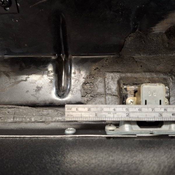

Finally putting the interior together in my 68 Charger. It has a rallye A/C dash frame. The glove box catch is spring loaded and the mounting holes
measures 2 1/2 inches apart. The dash frame mounting holes measures 1 1/2 inches apart.
Is there a smaller spring-loaded catch or a different type of catch ?
I really don't want to drill out 2 new holes into the frame.
Thanks

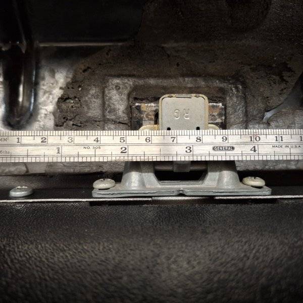

I would have to measure my 1969 but I would say 2 1/2 sounds right and 1 1/2 sounds to narrow.

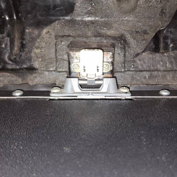

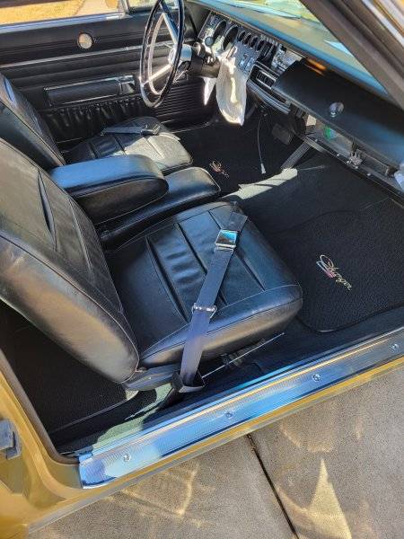

Well I'm no expert on those minor details and it is possible your 1st model year got some different parts BUT I think its more likely that all '69 B-bodies got the same dashes. The only differences being a) a/c or non-a/c and b) rally dash versus standard dash. Here are some pics ... '69 standard dash, non-a/c.

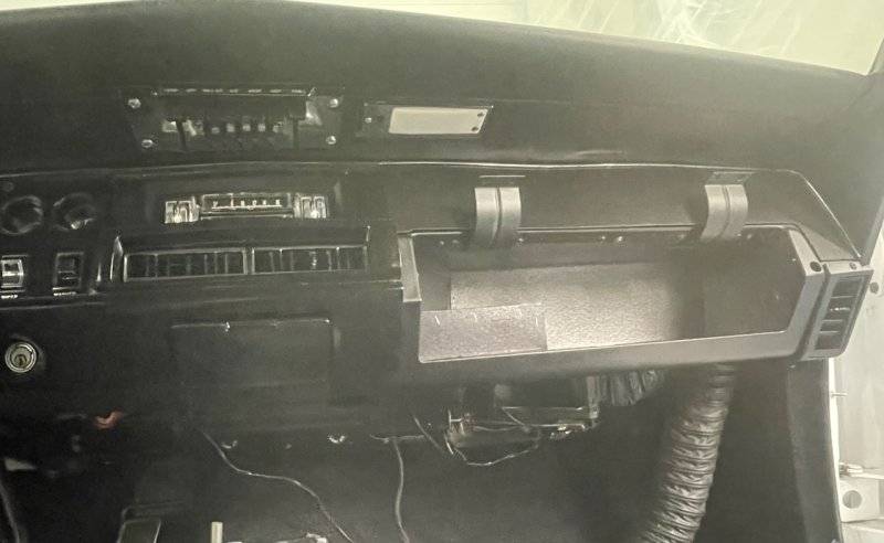

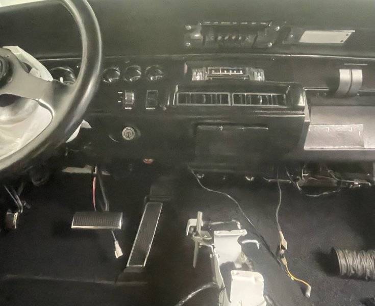

Thank you for taking the time and effort taking pics. Check my pics out. I cannot figure this out. It doesn't make sense. There has to be another latch. Last resort is to center it and drill 2 more holes. It's tough because there is not a lot of room.

My 69 is 2 1/2 inches apart. Are you sure your dash frame is 1968?

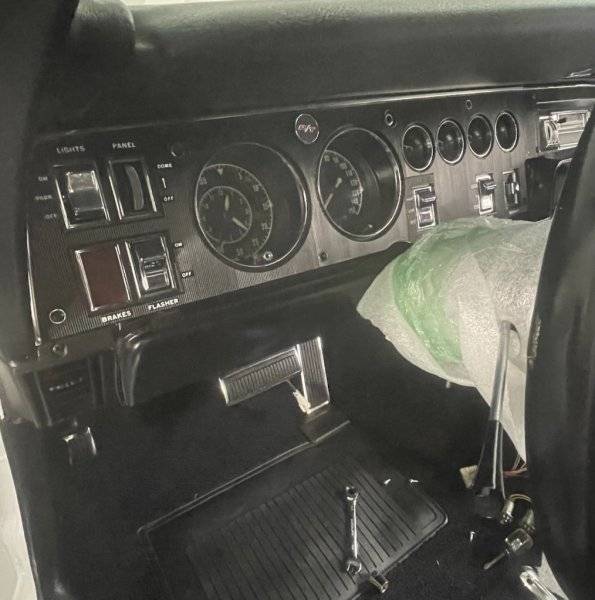

No I do not. There has been posts here from time to time on early models with odd differences. Like spare tire hold down, trunk hinge torsion rollers, and other taken for granted differences. I would drill the holes. Can you post a picture of your complete dash frame.
I did not see anything mentioned on the glove box latch. But the one picture the spacing looks like it could be the narrow 1 1/2. My 68 parts book shows two numbers for b-bodies but no explanation as to what goes where. 2857100 and 2927764. If there is an odd early one it may be tough to find. I did see this on a google search. Early 1968 Dodge Charge Coronet B-Body Glove Box Latch Catch Bar 2857100 for sale online | eBay

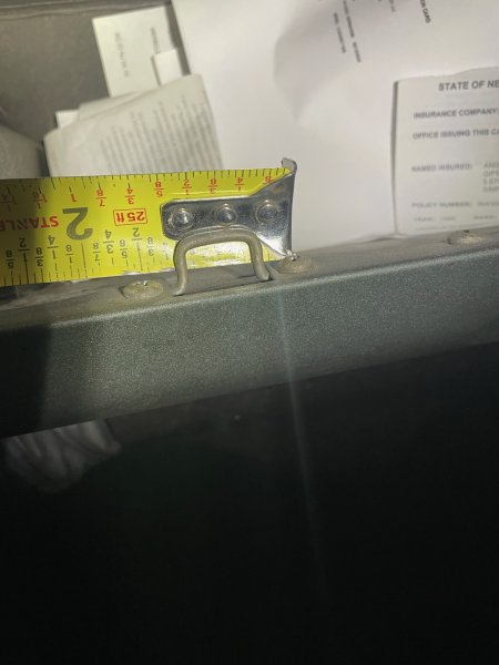

Evidently I have an early 68 dash frame. Below is the pic that was sent with the correct glove box latch ( 1 1/2 inch. )
Finally have this solved.
Thank you to all for all the pics and help.
