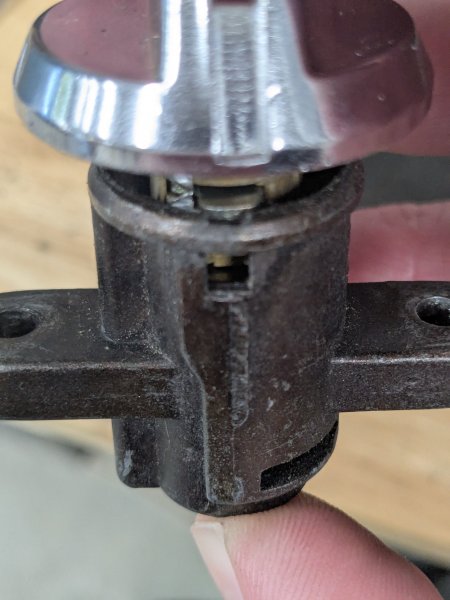

I'm trying to install a new lock on my 72 glove box. I know there's a tab that has to be depressed to lock the cylinder in to keep it from coming out, but it seems that the cylinder is too long. The same is true for the old lock. I can't push it in far enough to get the tab to engage. Without this, you can simply pull the lock out. It appears my latch is worn out, but Im not sure that's the issue. What am I missing?

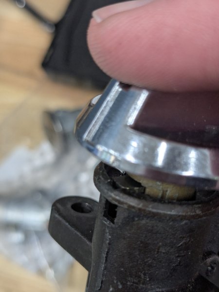

Yeah, I found a video that gave me the procedure. However if you look at the last picture, you can see where the cylinder bottoms out in the latch. Even depressing the tab, the cylinder won't move any farther.

Yeah the old one I could just pull the cylinder out of the latch with a little bit of a tug. The new one is acting the same way. That's part of why I'm replacing it (and I didn't have a key for it). I'm going to get my calipers out tomorrow and measure to see if it's physically possible to get it inserted all the way.

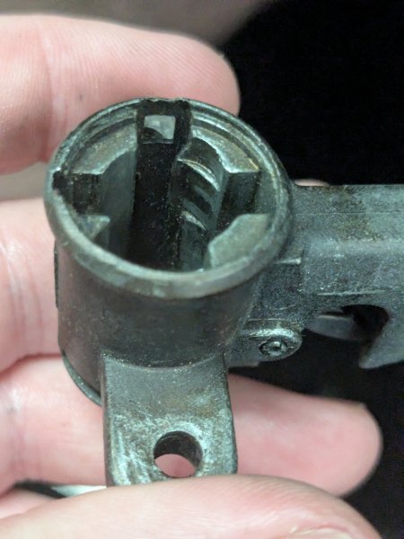

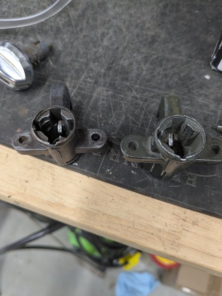

I got busy over the last few days so I just now had a chance to look into it more. I measured the depth of the latch and there's physically no way for the cylinder to go in deep enough to lock in place. Additionally, the locking tab is too wide to fit through the slot (see the first picture below). Could it be possible that I have a latch from a different vehicle? I wasn't the one who built the car and I wouldn't put it past the builder to install whatever he had lying around.

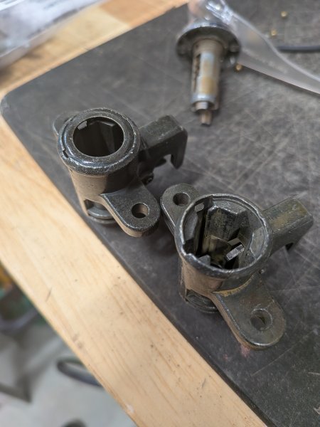

I ordered a replacement latch and while deeper, it has the same issue. Both are missing the pressed in retainer ring shown at the 13:00 mark in the video below.

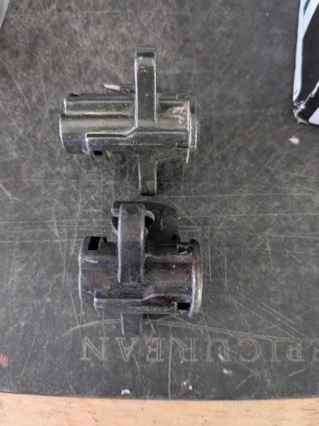

Here are the two latches. The larger is the repop.
I spoke to the vendor and he confirmed that it's supposed to have the retaining ring. I must have gotten a damaged one. I think it's going to be too long though. I'll probably have call around. I found one, but it excludes b-body for '72. That may be the version I just bought.
So for reference, here is was it was supposed to look like next to the original one I got. Just my luck that the replacement I received had the same issue and I lacked the prior knowledge to know what it was supposed to look like
Oddly enough it appears to mostly work even though it's too long. I have a feeling though that the stops aren't engaging and I'm relying solely on the tumblers holding the cylinder from over rotating. I picked up a NOS one off eBay that should settle the issue.
