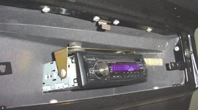

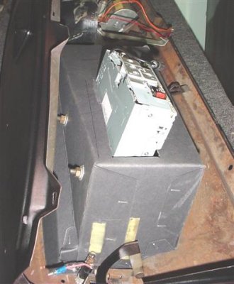

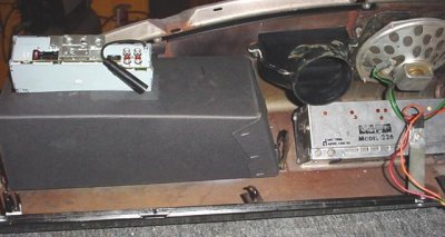

I got a new Kenwood am/fm/cd/mp3/bluetooth/serius radio..(whew)... off eBay for right at $100.00 and free shipping. Then bought a repop glove box liner for $20.00 and cut it to fit the radio. Once mounted it is quite sturdy and I really didn't loose that much space in the glovebox. I can still keep all my cars paperwoork and a few maps + plus the remote control and mp3 player in there. (notice the original radio in place as a dummy).

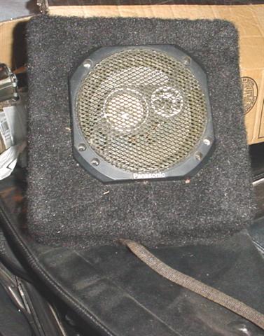

For speakers... I didn't want to cut anything so I made a pair of wood boxes...lined with styrofoam....and covered with carpet material. Then mounted my 5" 3 way speakers with about 10 feet of speaker wire leads. (routed behind the kick panel, under the sill plate and up through the carpet under the front seats.) Now when at a cruise in, show or drive-in I can set the speakers on the boot, (convertible), or outside the car. Sounds great too. I incorperated rc plugs for the speaker leads in case I needed to remove them for whatever reason.
Nothing in the car had to be cut and the dash and interior panels are original.​
