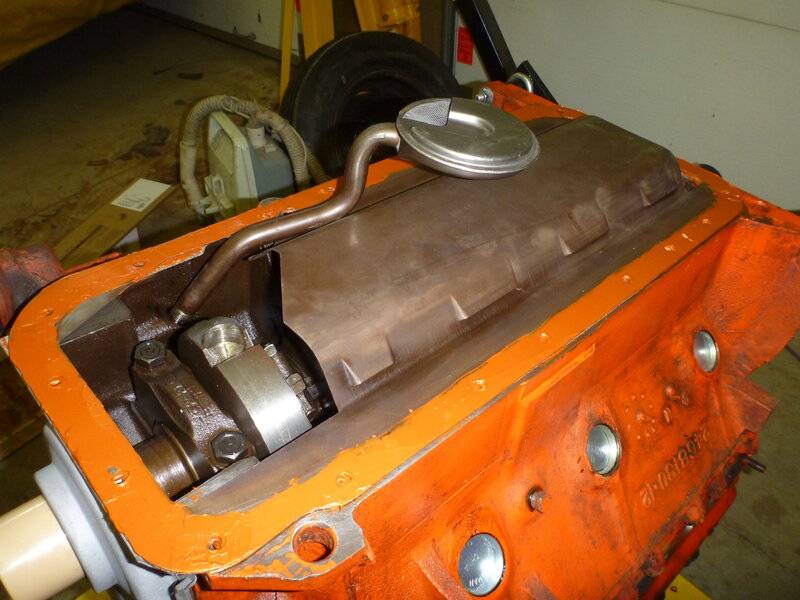

BTW Roger, that is the pickup you need to run the stock windage tray. Regular pickup doesn't have the S in it.

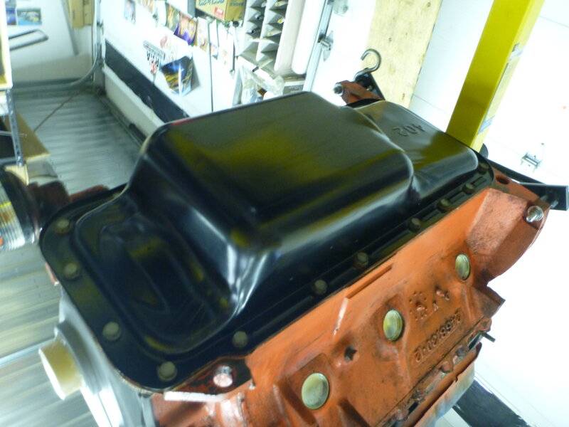

That's the right pan... but I don't think I paid much more than that for a shiny new one..

I bought a new 402 pan for mine 4 years back. Can't remember where I bought it... I'll have to dig through my bills...
View attachment 1060740 View attachment 1060741
That orange stuff on the flange of the tray, is that silicone? You really shouldn't use it that heavy as a lot of that is going to end up in your oil. Not good. I usually snip the tip of the applicator and run a bead around each bolt hole and then a bead between the bolt holes. Let it set up 1/2 hour or so then just snug it up finger tight. Couple hours later tighten to specs.
Trust me there's no more than a smear there and a cork gasket going on top before the pan.
