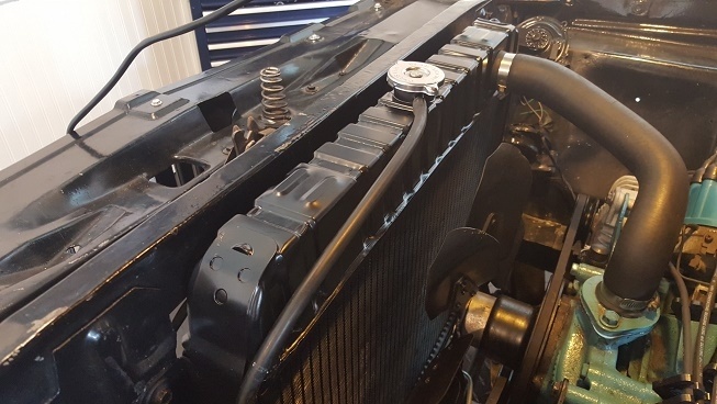

I bought a year one "replica" of my oem 26" radiator without the numbers on the top. Looks just like the original and fit perfectly! I've since added a fan shroud.
