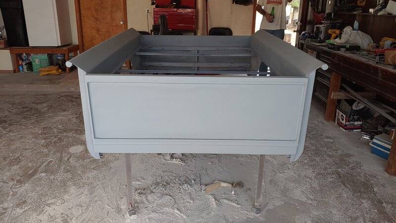

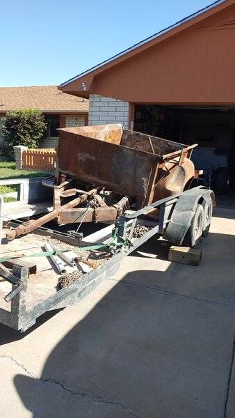

Started with this.
Ended with this
A sand blaster is man's best friend.
Sand blast, epoxy prime, and paint.
