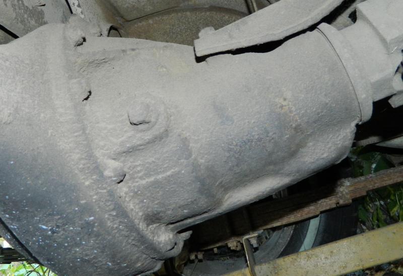

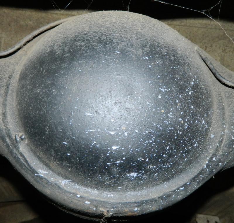

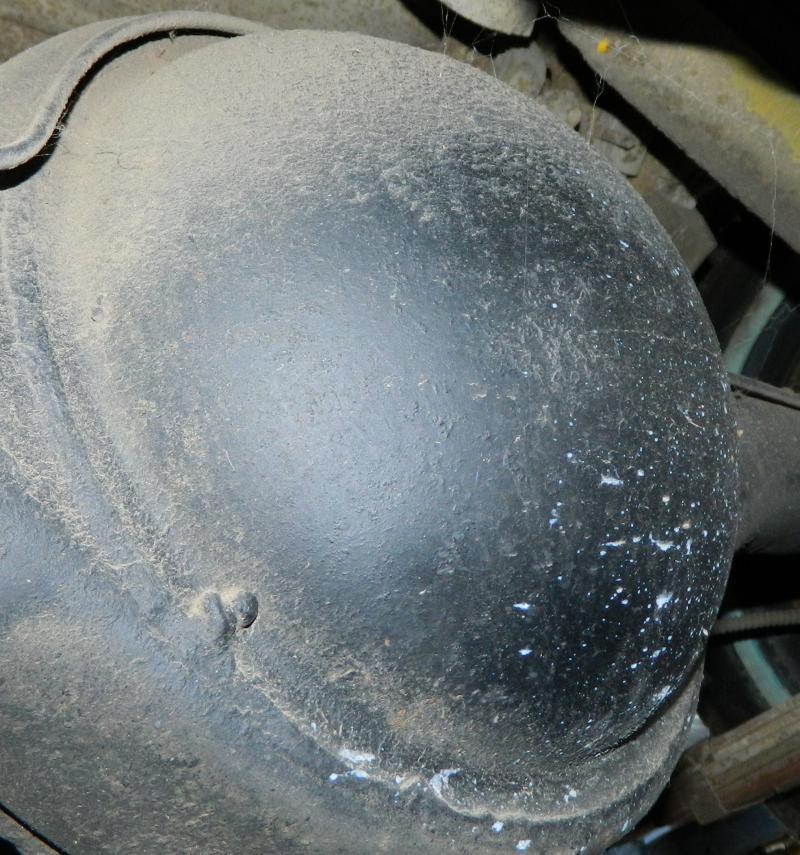

Well guys, I don't know if this is bad or good, but when I do one full tire rotation the drive line turns 2 3/4 full turns. So what gear is that, should be good to do 200 miles hr and not burn tires off lol.
Ya or might be 2.93 if I was off alitte, lol
