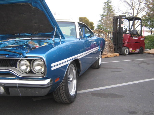

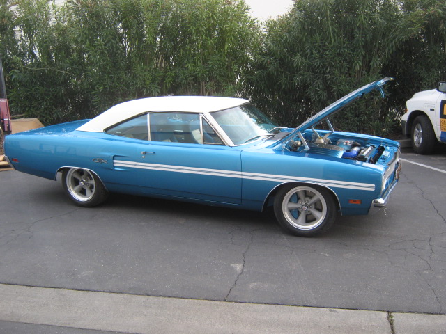

I am running 225/55/r17 BFG Sport Comps same size all around
I did nothing to the stock wheel well areas. I do have an AlterKtion though and the clearance is VERY close on some turns , at the frontmost lower fender opening right near the brace rod.
275/40/17 for the rear.
