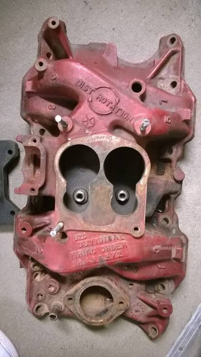

Found this intake for a fair amount of cash, figured I'll hoard some parts for the coming 318 modifications which hopefully will take place as soon as the body is fixed...
This is, as far as I understand, a stock 340 intake manifold. How old is this intake, ballpark? How can one tell?
I have no clue (because over here, I don't really have to care) about smog stuff, EGR and such - reading up on the subject on various forums mostly confuses me even more - according to some, the EGR stuff won't affect anything, others want to plug and obliterate any traces of EGR-related holes in the intakes. Where, if anywhere, would I find EGR valves/ports on this? If present, do I need to do anything about them? Please, educate me.
For a performance build plug the EGR for a constant fresh air and fuel charge. The EGR gasses are harmless and will have a minor effect that you'll never ever notice.
Give the numbers on the intake and as soon as I can, I'll look them up and tell you what year 360 that is from. Or it's the last year of the 340.

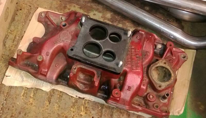

Here we go... the intake says BZG and below that, 3671918AE.
And a better pic:
Nice Photon. That is nice that there is no EGR valve on the drivers side. The floor jets can be plugged easy enough. You can make some good power with that intake.
Thanks guys! So it is a 340 intake then, not 360?
Also, any advice on best way to plug those floor jets?
Being that I have not had that exact intake though looking at the picture on my phone says to me they can be screwed out. Take a ratchet to them and then instal a hex plug in its place.
Yep, that's the early floor jet EGR intake. Do as Rumble said - remove the jets and plug them. You don't want ANY exhaust gas in the intake stream because it will be seen as a vacuum leak (too much that is).
You may find the threads are a parallel thread (not a taper pipe) so you may have to drill larger and chase them with a pipe tap or remove the plugs and weld them closed, or plug the plugs with a pipe plug. I remember plugging those at some point but don't remember the exact details. And yes, that intake will do very well on the street with a mild cam.
