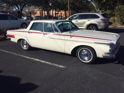

The radiator is now leaking, any suggestions on getting it rebuilt?
And the Auto transmission is leaking from both front and rear seals and ideas on a way to fix without pulling out and putting in new seals. I'm sure all problems stemming from being driven very little for the last 45 years. I believe car only has 34000 miles in total.
Thanks
What engine does it have, so as to know what radiator you need ? A lot of good used items here on the site...
Well...honestly, different advice on whether or not you're flippin' or keepin'....
If it's a keeper, have the transmission gone over and resealed.
The radiator can be repaired/boiled out/serviced by any decent radiator shop.
For the trans you could try the cheap way out by using a sealant. Napa sell a product called "Seal Lube". It does not change viscosity and can be used in almost any thing with oil in it; example , Engine, trans, rear, power steering, etc. I have seen it work wonders. Good luck! By the way, if I missed you, belated welcome aboard! Car looks great!
