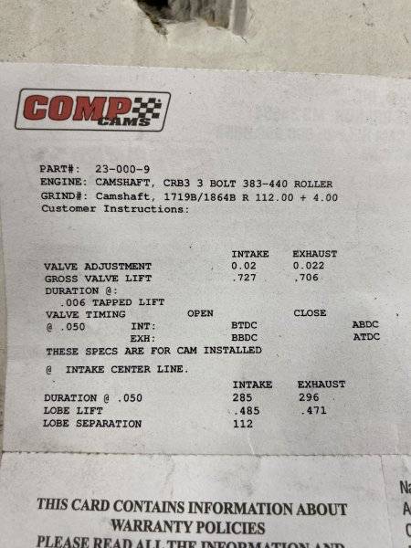

For the very short amount of time I was able to drive it (as it vibrated my center console out of the car) seemed fine and responsive, Idled well, really not much different than my old .262/.262 @ .050 .645/.645 Lift I ran for years and that was great in a 440...

Please no decimal behind cam duration :) Also, "cam is good for efi but carb hates it" makes zero sense.

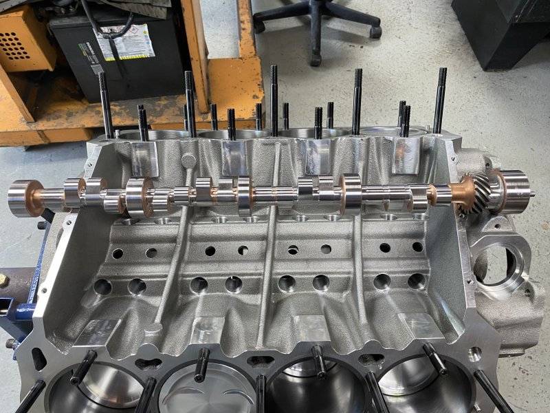

Just an opinion but I think you have enough cam, cubes and cylinder head to make more power. If it was induction restricted I think you would see it peak at a lower rpm.
So, that all leads me to........ You mentioned in a previous post it cranks super fast and has 120psi compression test.
If that's still the case I'm guessing it's more like 9-1 instead of 11.5-1.
Do you have a photo of the piston in the block at TDC?

The cam uses lobes that have been around long before the term “low shock” was the buzz word.
Based on the specs, those were the lobes I suspected were being used.
I have used that family of lobes in high HP BB Mopars for a pretty long time.
Every engine builder has their own way of doing things, and the people at Indy have built countless high hp engines.
That being said, my take away from the specs of the build and the(imo) rather low cranking compression numbers is……….the cam is too big.
But………after the new induction and EFI are installed…….the chassis dyno will show how it all bares out.
