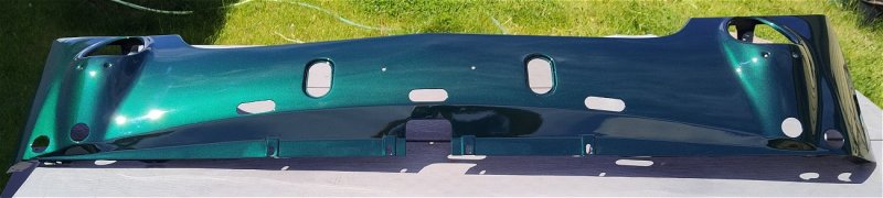

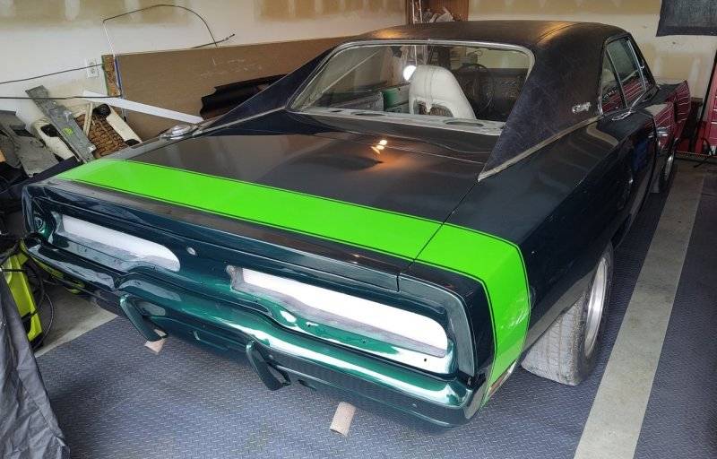

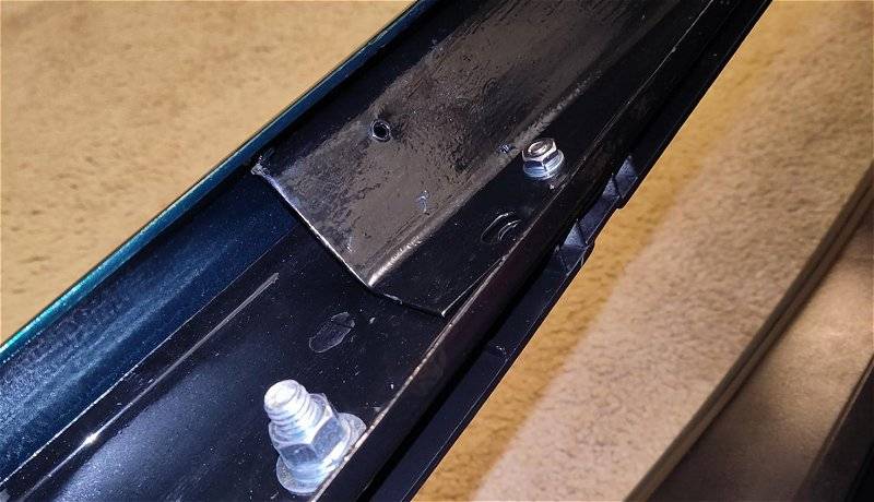

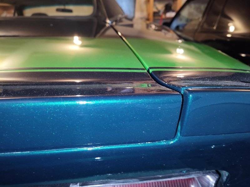

Grendel broke out of jail and is now back in her cave. Now begins a TON of work...I got the taillights installed and I'm working on the finish panel. I removed all the existing black paint--and some blue and orange, didn't see that coming--which was easy with some acetone and a grey scuff pad, but it looks like removing the anodizing will take more time. I used Easy Off oven cleaner but the job's far from done. I am considering repainting the whole finish panel SEM Trim Black. Those dated rims & bald rubber will be gone after I get the new fuel tank and stainless fuel lines installed. The vinyl top needs a good scrub with a brush and 303 Aerospace Protectant.
