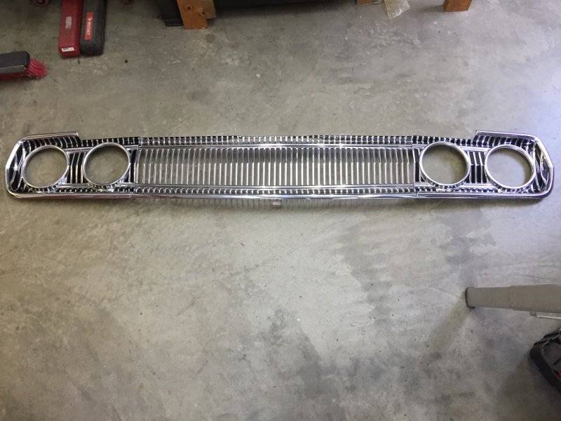

im making a drag car 330 64 dodge with a 426 max id like to make the grill like the single light hemi style how hard is it and if any pics it would help thanks
I always tig them, just my preference.
On thin aluminum, I use a stainless backer and start out with low amps with the tig rod at the ready.
Here’s a 64’ grille that I converted a long time ago and the owner had a “accident” so I was able to fix it. The 65’ Coronet grille was a just a fix and polish. I’ve done 2 single headlight conversions for that year.
