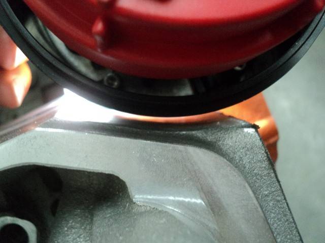

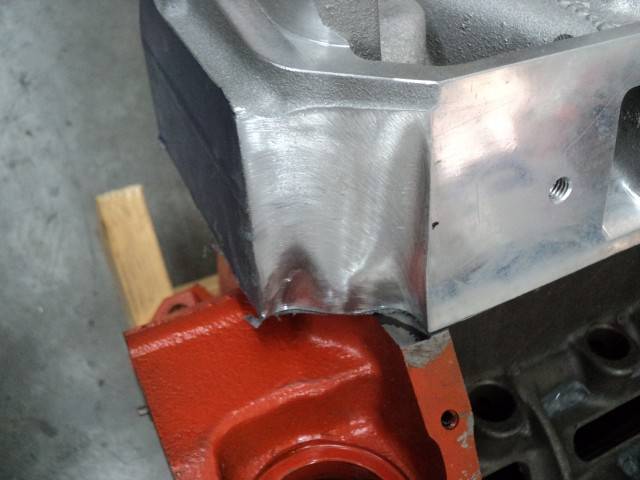

I stold these pictures years ago when I was considering doing the same
I personally think you can get clearance with much less grinding.
