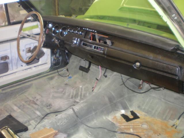

I put a ralley dash in my 70 satelite convertible , went right in , but yes you have to change the whole thing
nice looks natural

mine is an A/C dash and pebble black finish for a road runner instead of the wood grain but you get the idea
