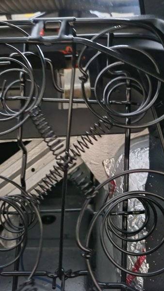

I figured out a way to determine where to locate the upper rear seat hooks. I tied the seat frame to hold it in place. I then managed to slip a hook behind the seat frame, and mark it with orange paint. I drilled holes in the hooks to fasten them with screws until i weld, or use body panel adhesive to secure them. I used the holes to mark where the hook will go. Notice the steady hand? :) i managed to mark the hole. I got the hooks from Jim Drain. Btw I wasn't sure how the seat frame would work in a 4 door sedan. It fit like it was mean't to be there, of course the lower mounting brackets are on the way from Stephens Performance. 3 more hooks to mark.
