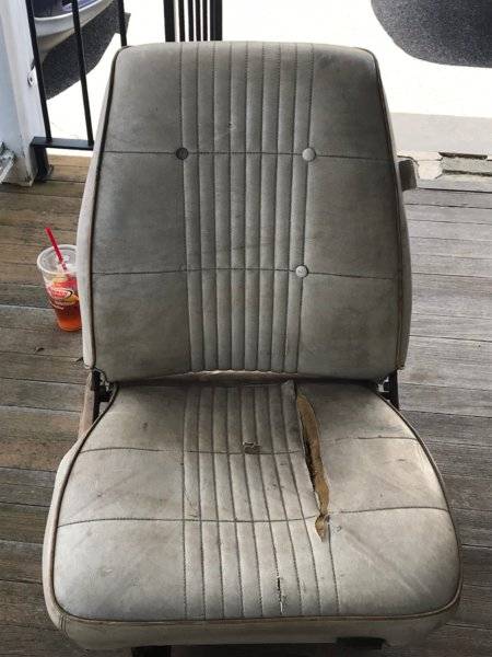

Got these seats when I bought the car. Out of the thousand pics I’ve looked at, I’ve seen only one other pic of seats like this in a 68 GTX. Are these the right seats? Any ideas guys?

That is from a 1968 Coronet 500 and R/T. Should be the same tracks and frame. Foam could be different, they can change with the covers.

Appreciate that. Wanted to know for sure before I do the seats over. Thanks

Consulting the Legendary Auto Interiors website, R413 is correct on application.
Also according to Legendary, all A and B-body '68-'69 Mopar bucket seats used the same foam.

Thank you Mopar.
