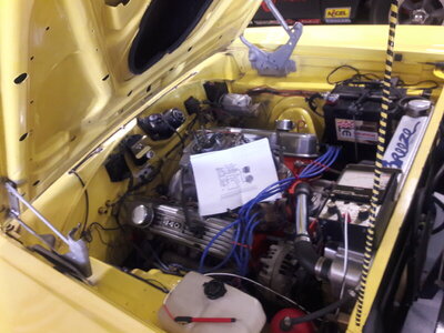

Photo of the process. Note I printed out the diagrams @Jerry Hall attached.
My trusty Sencore analog VOM has been with me since my TV repair shop days in the late 1970s.
