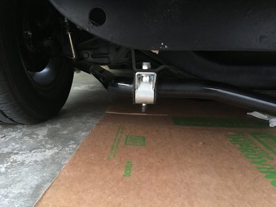

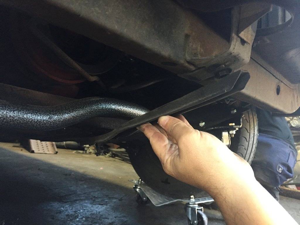

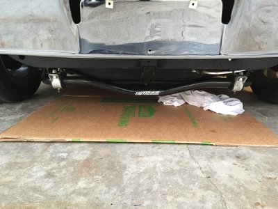

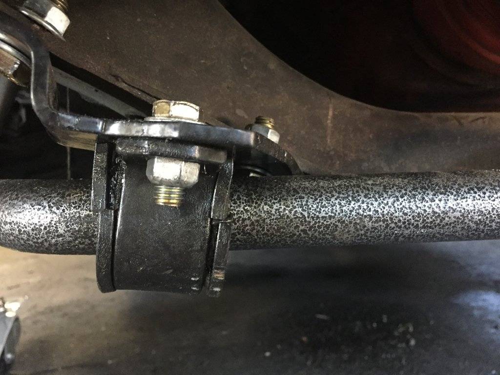

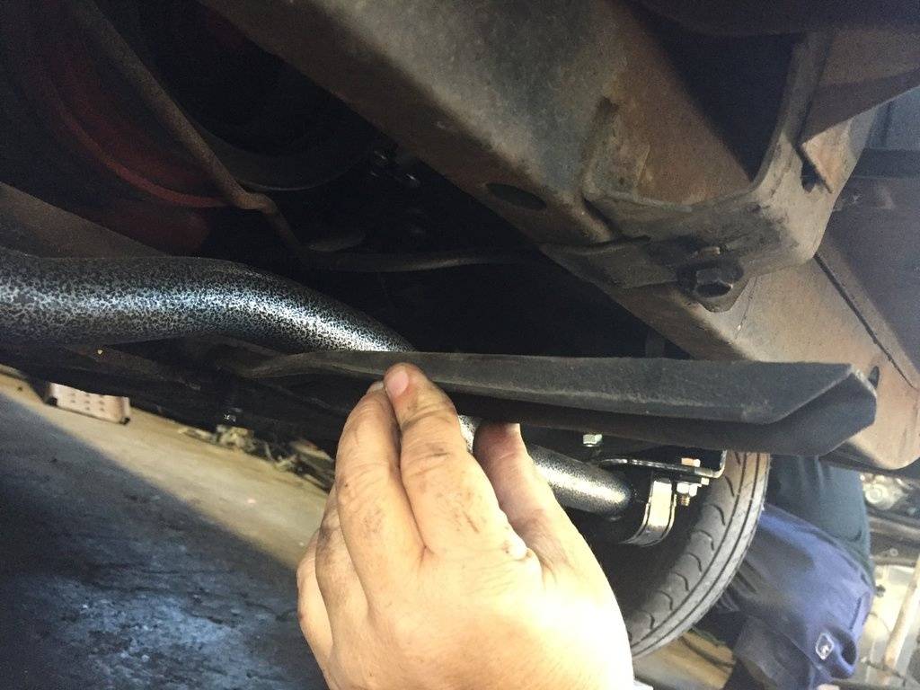

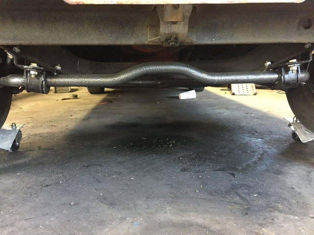

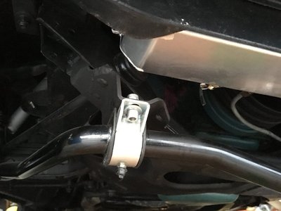

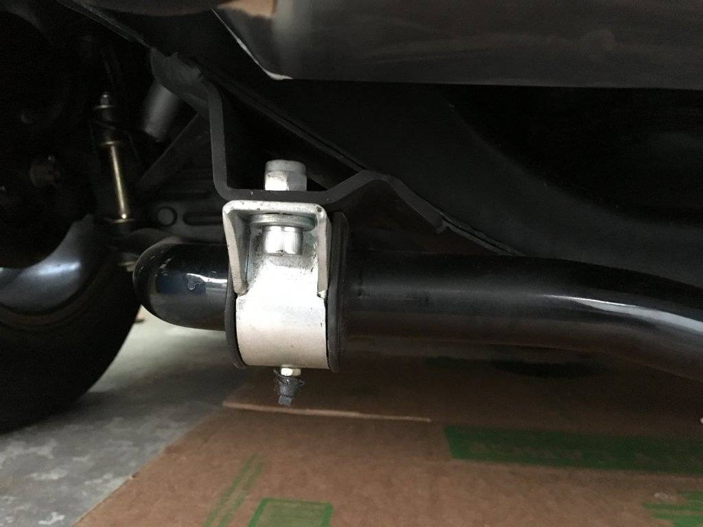

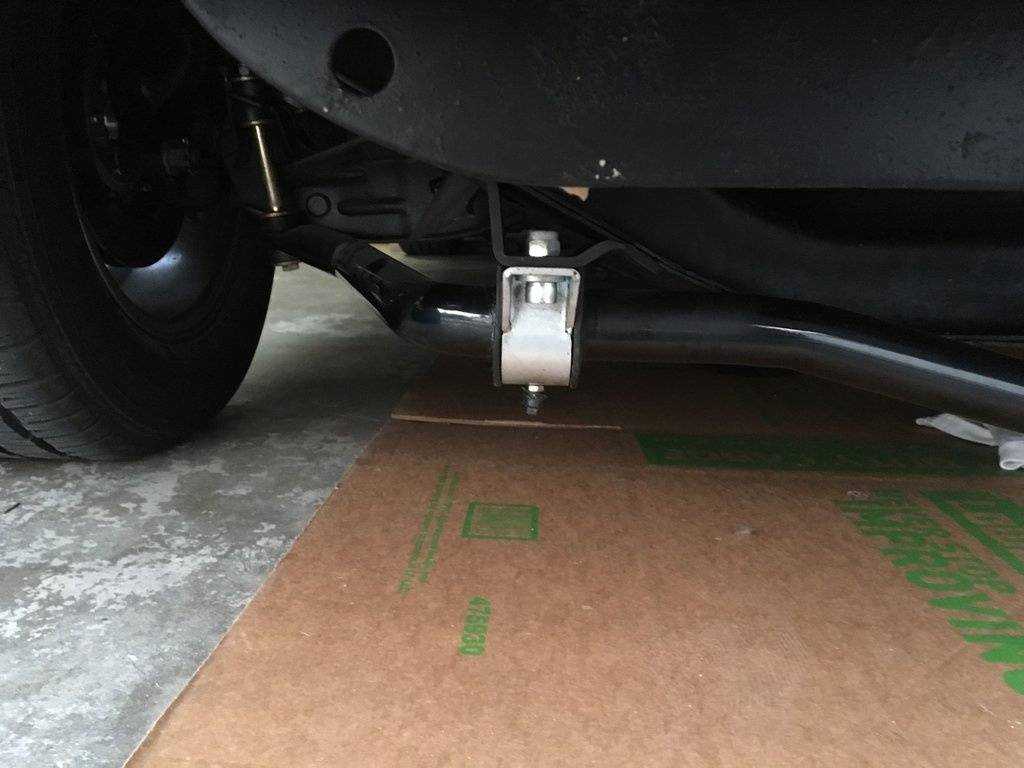

Hey guys, check out the pics of the sway bar that I mounted. The pivot points do not seem to be 90°. Also, the bar that connects the K frame to the base of the radiator does not fit anymore. I called up Summit, and they don't know what to tell me. What do you guys think?

call Summit and ask what company makes it and give them a call. That looks like a Hellwig sway bar.
Guess what? SOMEtimes, aftermarket stuff just does not fit right and you have to improvise. I'd modify the brackets or put spacers at the outer edges to get the D bushings square. Regarding the K member brace, sometimes the aftermarket 66-69 B body bars fit better with that dip pointing down instead of up.
i would say flip that bar. looks like kframe mounts needed to be moved toward the center just a bit
i put a hotchkis front sway on my 66 Coronet. the dip points down.
will get some pics
watermelon
I see that your mount has the correct (steeper) angle for that position. I very well may end up welding mine in closer to the center.
