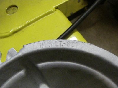

So I got a set of Autopal H1 conversions to my 69 roadrunner. Noticed that the small tabs on the backside of it that are supposed to line up with the buckets are about 1/8" too far apart. You can safely just cut them off so the H1 light sits using two tabs instead of all three right?
Just wanted to make sure before I put them in :)

Brights and dims are keyed differently. Check that your receptacles ("buckets") are in the right locations and that nobody swapped the wiring on you.
Yup! Check the outer edge of the bucket's to insure they're in the right position. "HI/LOW" is outer light's, "HI" is inside lights. Also they are labeled left-hand "LT" and right-hand "RT" as well.
I went through the same thing, I had to get 3 sets before I had any the same, glass mould where off
I took my buckets to supplier, and test fitted, till I found a pair the same
