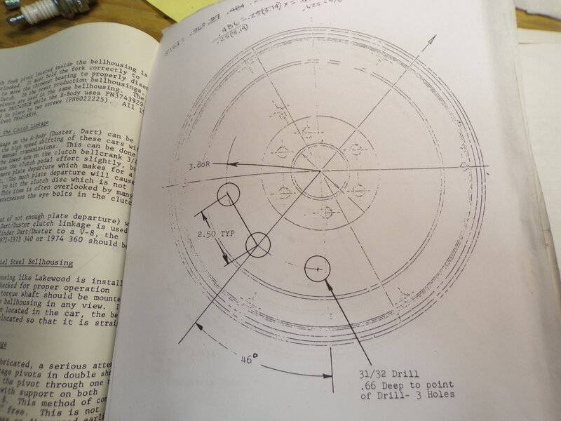

The cast crank 383's and 400's use the same flywheel and torque converter offset balance. This leads me to believe that the 383 and 400 damper should interchange (though I have not been able to verify this). The flywheel must be balance to the cast crank 383. Below is how the old Direct Connection book shows how to balance a flywheel for the 383, 400 & 440 cast crank engines The same flywheel offset is used for all three engines. The drawing is showing the engine side of the flywheel.
1) Use a neutral balancer and flywheel and re-balance the engine 2) Balance the flywheel (per above), then look forever for the correct balancer. (Damper Doctor in CommieFornia can rebuild it for you) 3) Get a steel crank, neutral balancer and flywheel, and still balance the rotating assy.

Thanks guys, Here is what I "think"? The HB for the 71-72 cast cranks 383's had the one offset pulley bolt hole. In 73 when the 400's came out the holes were then drilled equal and a new part number was required.???? SOOOO same balancer on either cast crank engine,,,,, I can not see the three drilled balance spots in the flywheel, so I'm betting that is my problem. I need to remove my flywheel and drill those spots. ORRR get the correct flywheel, Brewers offers the flywheel neutral or balanced (drilled) Brewer's Performance - Mopar A833 4-Speed Transmission and Component Specialists
