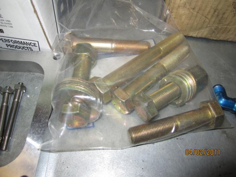

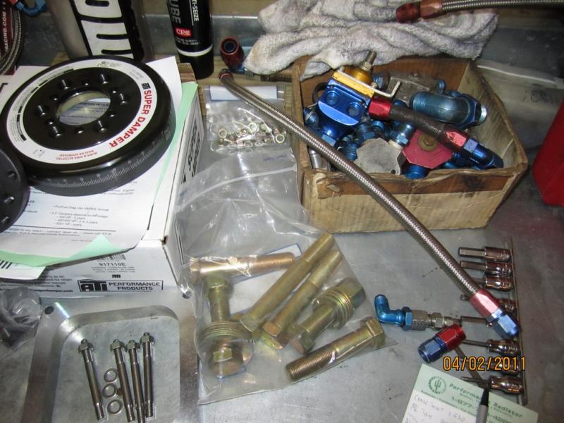

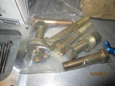

I made my own from a long bolt,a huge washer and a roller bearing to make the last few turns a little easier.:headbang: 4.2.11 (8).jpg4.2.11 (7).jpg
Believe me I wanted to do the same thing. I went to 4 stores and nobody carries an M14 x 1.5 thread around 5 inches long.....nobody. Except Fastenal and they closed up shop. So short of doing like I had to do last time and borrow one from the local dodge dealer (no way id get somebody to loan it to me now) this was about all I had without having to order the $100 tool.
