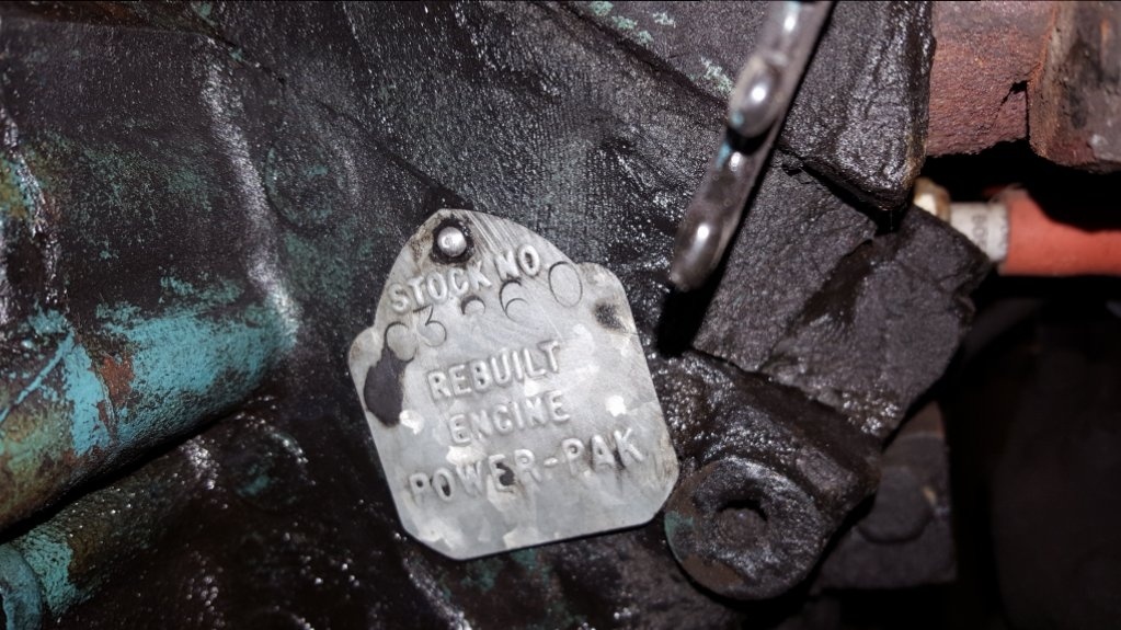

Hey everyone I was hoping to get some information about this tag. I found it on my 67 charger...I guess this means it is not a numbers matching car
View attachment 379270 Hey everyone I was hoping to get some information about this tag. I found it on my 67 charger...I guess this means it is not a numbers matching car
This was a rebuild by Automotive Engineering. I remember in the SF Bay Area, this company use to advertise in the newspapers. There were locations in other areas as well (LA for sure). The Bay Area facility was in Oakland. Most of the time, people (or a repair shop) gave them their blown motors and received a rebuilt one but I do know 2 people that took their motors there and had the originals rebuilt so there's a chance yours could be the original. Check your numbers.

That looks real similar to the warranty block tag on my 67 318 Wagon.
Even riveted to the block the same way, in the same spot.
Could it have been rebuilt by a dealership?

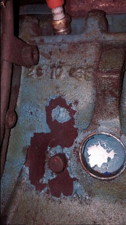

What's the casting date on your block?
Does it jive with the build date on your fender tag?
Those are the only "numbers" you get on pre-1968.

Usually, mnfr warranty motors will have a blank ID pad whereas Automotive Engineering rebuilt used motors.
67's just need date-coded engines.
Thanks for the details. This makes sense. I know the car has spent it's entire life in the Bay area. Now I have to find the casting under all the gunk.

Well that pic answers the numbers matching question.
My cousin bought this car brand new off the lot. When the engine needed a rebuild he took it to a shop in the Mountain view area and paid to have his engine rebuilt. He always suspected that they didn't do a rebuild and just swapped engines. Now I know for sure.
...but back to the"matching" scenario for a 67....
All you need to do is find a block/engine (and accessories) that has a casting date a few months before the build date of your car, and.........voila, you now have a "matching numbers" car.
That's the beauty of pre-1968.5
It actually needs to have an assembly date within 90 days of your cars spd date. This will make the casting date prior too.

I also have a 383 here out of a 1968 charger that lived in Oakland ca all it's life with the same tag on the block.
I replaced it with an edelbrock headed 440
