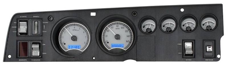

Been looking at the Dakota Digital rally gauge sets. Just wondering if anyone has installed one of those in their B Body? Wiring looks pretty involved.....
I plan on getting the gauge set for my 71. It looks very simple to wire. All of your wiring goes to the module and then a cable goes from the module to the cluster. To me it seems easier than wiring each gauge individually.

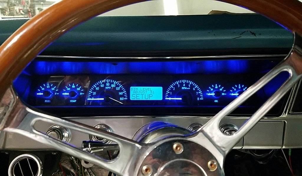

I purchased and installed a set in a '55 pickup street rod I built. I was very happy with the results. Tech support when needed was excellent. I also liked the look and function. The wiring goes from the box to the senders and box to power panel. When ready you just plug in the gauge panel with one cable. Does dash lights and all. The instructions take you step by step through the calibration process. That's toughest but not rocket science. I would buy again. Dave

The kit comes with all of the sensors and is pretty straight foward. The VHX series does have a cpu about the size of a small book. You may need to order a VSS to adapt your mechanical speedometer to a pulse signal.
Programming the speedo is probably the most difficult piece.
It has a lot of great features, you can set your oil pressure warning message, 1/4 mile dyno, shift light, service engine ect...for the money its probably one of the best!
