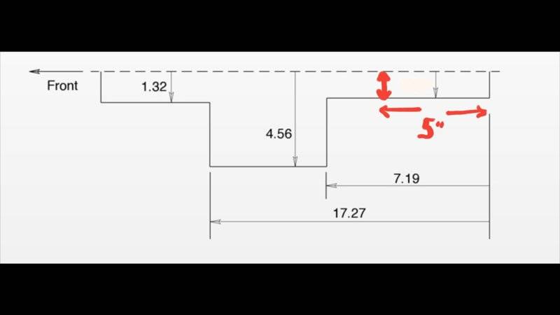

I would like a measurement on your new pan if you get the time. The height of the area where the centerlink passes by to the flange that bolts to the block. Use a straight edge across the flange and measure down to the area where the centerlink would be.
The pan that I used is really too close in this area. I know as my motor mounts settle over time its going to be touching. I like the looks of the pan you bought and I'm hoping its not as tall in this area.

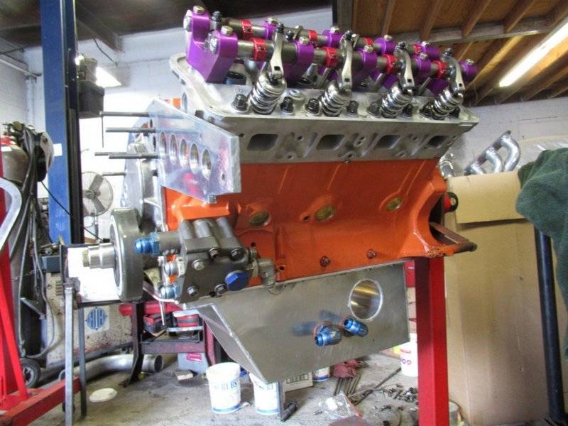

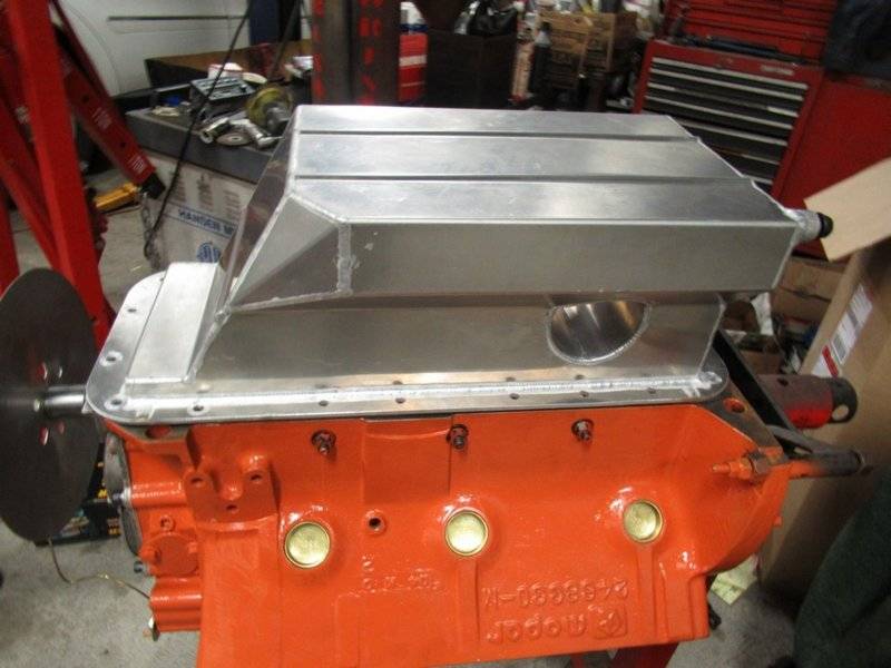

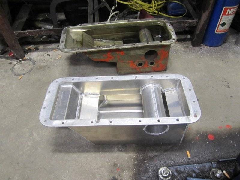

I bought that pan and used this pick-up on my 440 block. Had to trim the front of the windage tray due to how shallow the pan is at the front.

C.Dave, I see they offer that p/u in a 1/2" tube, which is what I need. Did you need to shorten the overall length, or just trim the windage tray ?
The pick-up fit without modification. My windage tray is a Milodon. I had to trim approximately 2-2.5" from the front, due to the pan being so shallow in order to clear the K-member in a 63. Left the rail in tact, just zipped the tray part. Darn; should have taken a picture or 2...

Hey Dan, I was looking for the measurement on the section of the pan before you put the pan on! Lol
Here's what I'm looking for. 5 inches in from the rear of the pan I need the height.

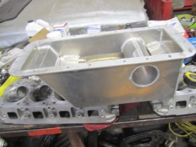

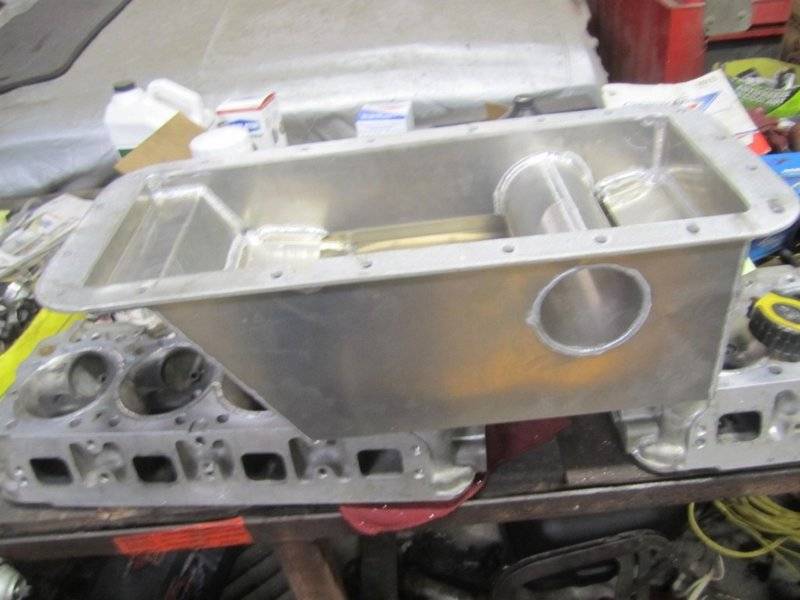

From front, 1 1/4" to 2" on original Max Wedge pan
